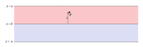

In the layer ##0<z<a## there is a uniform and constant density of charge ##\rho>0##. In the layer ##-a<z<0## the density of charge is ##\rho<0##.
What is the total electric field in the space?
By the Gauss law I find that if ##z \geq a## or ##z \leq a## the electric field is 0. But inside the total layer how can I procede? I rebember that there must be a term ##a^2##(!), but I'm not sure. If I integrate I have ##E_+=\int_0^a{\frac{\rho}{2 \epsilon_0}}##, the same with the ##E_-##. The total is ##E=\frac{\rho a}{\epsilon_0}##.

Let P be an arbitrary point inside the positively charged portion of the slab. Choose an appropriate Gaussian surface that goes through this point and also allows you to make use of the fact that E = 0 outside the slab.

Suppose you want to find E at a point P located as shown. Try to use Gauss's law. Think about the shape of a Gaussian surface that will get the job done. Assume that E = 0 outside the charge distribution (even though you still need to prove that).

If I take a cube of side a, at height z. The surface I consider is the down face of the cube. I have ##E \cdot a^2=\frac{\rho a^2 \cdot (a-z)}{\epsilon_0}##(?)
Yes, good. Be sure to note the direction of E at P.
The vector is ##\vec{E} =- (a-z) \frac{\rho}{\epsilon_0} \hat{z}## (##\hat{z}## is the positive versor along the z-axys)
Looks good. Does this expression also hold for points in the negatively charged slab?

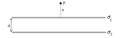

Suppose you had just two infinite planes of charge separated by a distance d as shown. Top plane has uniform charge density σ1 and the bottom plane has charge density σ2,
Diagram of two parallel infinite charged planes: upper plane labelled σ1 and lower plane labelled σ2, separated by distance d, with point P a distance x above the upper plane.
Find E at point P located a distance x above the upper plane. Does the answer depend on d or x?
Actually, it doesn't depend on d neither on x, because the field generated by an infinite plane is uniform in every point of the space.

Yes, because it would be ##a+|z|## but z is negative so ##a-z \rightarrow a+z## (if z is negative)
I'm not sure I follow. Shouldn't the field at ##z = -a/2## be the same as the field at ##z = +a/2##? Also, shouldn't E be zero at both ##z = a## and ##z = -a##?
Yeah, I'm wrong, the final expression of the field is ##\vec{E}=(|z| -a)\frac{\rho}{\epsilon} \hat{z}##
Yes, nice.
