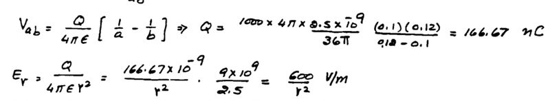

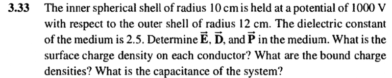

I have the full solution, the first part being:
I don't understand how they came up with the expression for Vab. I know usually ΔV=-∫E dl, but I'm not sure how they found their expression. Can someone explain? Thanks.
Yes, you can think of their expression as coming from ΔV=-∫E dl if you express E in terms of D. Use Gauss' law for D to obtain an explicit expression for D in terms of the free charge Q on the inner conductor.
