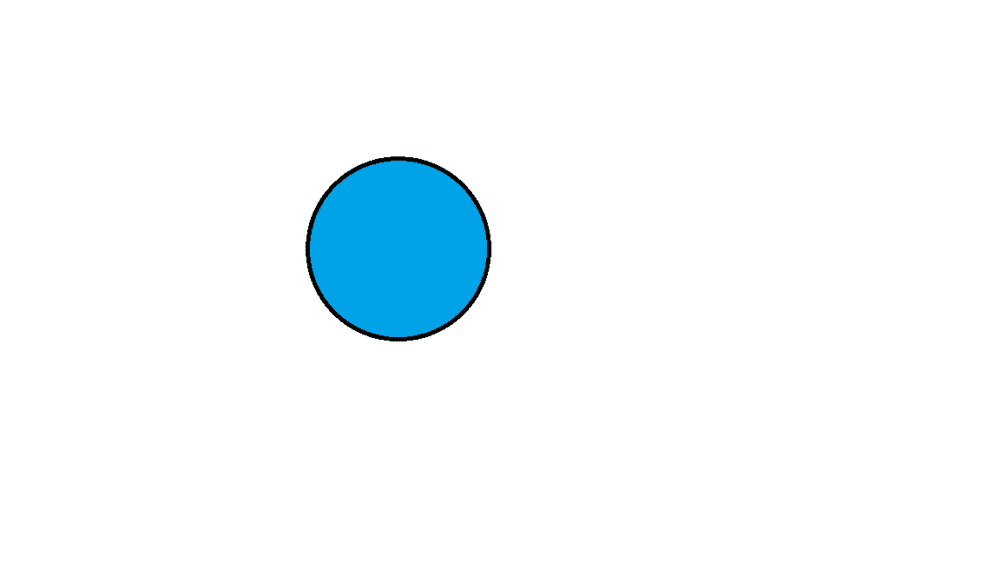

Hi! My main problem is that I don't understand what the problem is telling me. What does it mean that the surface is a flast disc bounded by the circle? Is the Gauss surface the disc? Does that mean that inside the circle in the figure, there is a disc?
Can you give me some guidance on how to begin solving the problem?
The black (and curved) line is the circle. The blue area is the disc bounded by the circle.
A circular disc is a surface but is not a gaussian surface. A gaussian surface is a closed surface that encloses a 3D volume pretty much like the surface of a sphere encloses the volume of the sphere. if you can imagine that the blue disc blows and stretches (while the boundary of the disc (the black circle) remains unstretched) towards yourself then this streched and blown disc would make a gaussian surface( I know its kind of hard to explain with words without making 3D schemes).

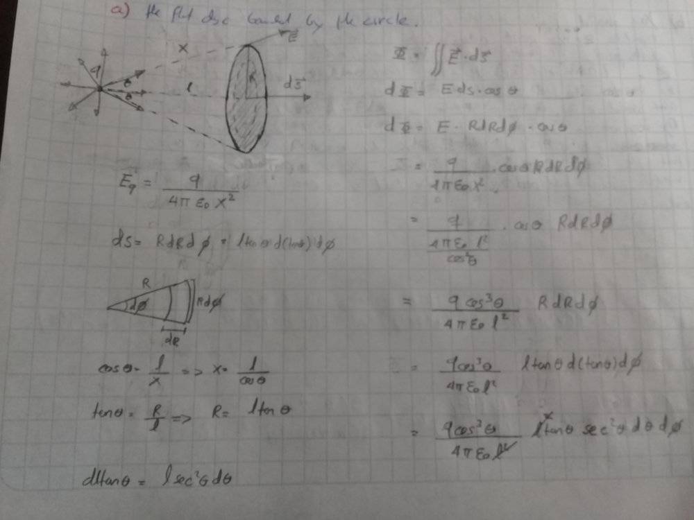

I understand, thanks. I think I made it, is this correct?
Work at image1 looks good.
