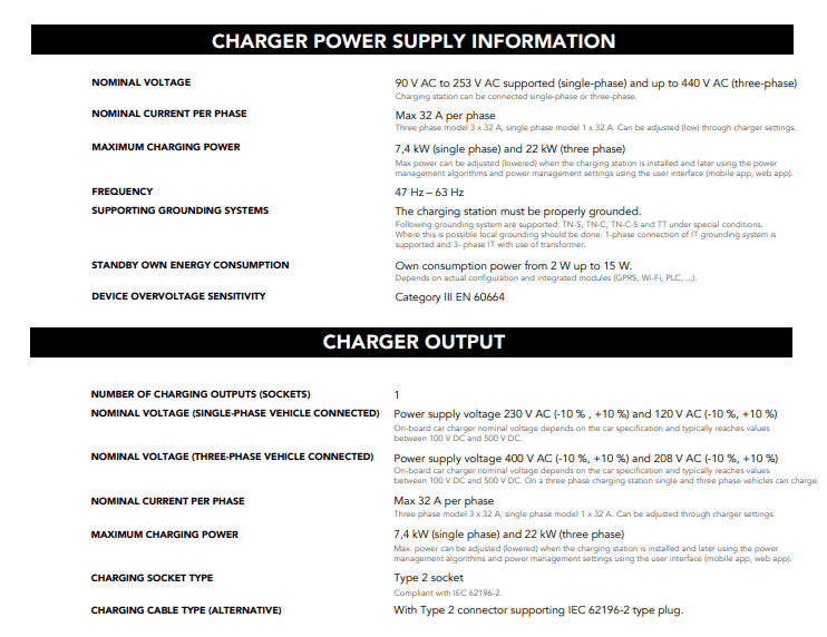

I work at a company that sells chargers for electric vehicles and I’m working on the electrical projects.
The chargers I work with, are alternating current (AC) and the main mode here is a three-phase installation 220 V, at 7.04 kW with a current of 32 amps.

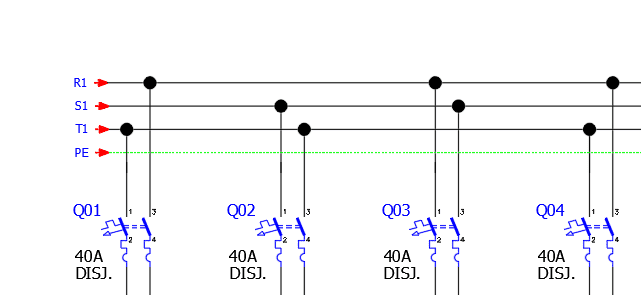

If the system only had three chargers (Q01, Q02, Q03), the current for each would be 32 amps.
Using a simulator, when adding the fourth charger(Q4), the current goes to 84 amps and I wanted to understand why.
I tried to draw the three-phase circuit to make an equivalence of loads, but I couldn’t get to that value.
Does an electric car behave like a delta or star load?
It's not 3 phase exactly, it's 3 single phase loads on a 3 phase line. Then adding a fourth puts two chargers on the same pair of legs.

You have created an unbalanced three phase system. That is much more difficult to measure and analyze.
In an unbalanced system, we deal with positive sequence, negative sequence, and zero sequence voltages and currents (collectively called symmetrical components). In an unbalanced system, delta versus wye connections are critically important.
See https://en.wikipedia.org/wiki/Symmetrical_componentsAre you sure you want an unbalanced system?

You say 'the current goes to 84 amps'. What current? Measured where? Trigonometry should get you what you need to know. I'm not familiar with charging systems for electric vehicles but as @russ_watters said, you have 3 individual single phase loads on 3 different phases of a 3 phase source. To figure the currents here, forget the fact that you have electric vehicle chargers, it makes little difference. Adding a fourth in the manner that you have will certainly throw the balance off but this is not at all uncommon. As I said, basic trig should get you there.
So the breaker panel has 32 Amp breakers on each of the 3 phases?

If the breaker panel is only sized for 32A/circuit and each charger load is right at that limit already (probably a bad idea), why are you trying to add any more load? Or are you just saying that is the max available current per charger when there is only one per phase pair?

Huh? Your cars look like single phase loads to me. You're the one creating the three phases, not the cars. Or, perhaps they are three phase loads as you said, in which case your schematic makes no sense to me. I'm confused; I think it's because you are confused.
Anyway, since I don't see any neutral connection in your diagram then there is no significant difference between the delta and wye topologies. You could model it either way.
I'll second the vote to ditch the simulator and just add the currents up with simple vectors, you'll understand it better that way, and it's not difficult.

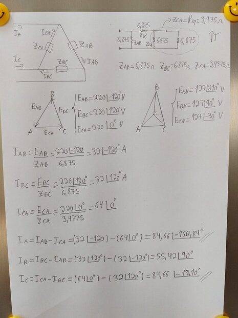

Thank's for the help. This is how I solved it

So did you understand the comments earlier about an unbalanced 3-phase load?
Also, what are the breakers in the distribution panel sized for?
I understood. It looks like you guys solve the unbalanced circuits in a more complicated way.
I was sizing the circuit current first, to size the breakers in the distribution panel.

Then you did it wrong. Typically breaker is sized to protect the wiring. If the full load current exceeds 80% of the rating of the breaker on a constant load, you have done it wrong.

Yes it was. Subtracting two vectors is indistinguishable from trigonometry, however you do it.

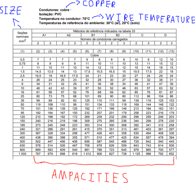

I would be interested in seeing a chart that is accepted in your county of wire size ampacities.
This is the chart for wires made of PVC 750V, we also have wires made of EPR or XLPE 1 kV, but it's in another chart.
The letters above refer to installation methods, like cable tray, conduit etc.
Sorry for my terrible handwriting, I was translating for you.
