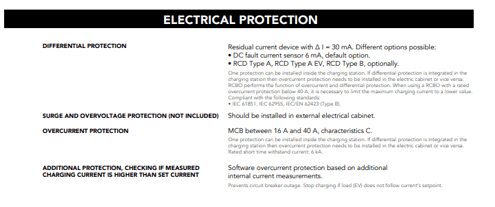

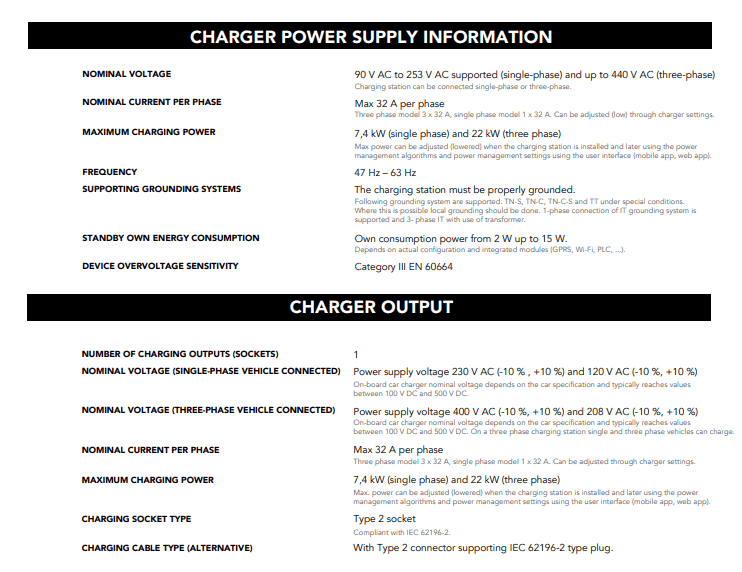

This more in-depth technical information only the charger manufacturer has, we buy the charger from a factory in Europe. I will show you some information that I have.

I don't see anything about Power Factor in the datasheet pages (maybe I missed it?), but it looks like it can run off of all 3 phases too. Wouldn't that be a more balanced way to run the multiple chargers?

After reading the data sheets you supplied, I note the following:
  1. Two different models are available: SIngle phase, and Three phase
  2. The Maximum Charging Power can be adjusted at installation time
  3. Overcurrent Protection can be 16A to 40A, probably depends on setting of Maximum Charging Power
  4. Maximum Line Current is 32A
Given 3 & 4 above, the Circuit Breaker should be 125% of Maximum Line Current.
Note also: The breaker short term withstand current should be 6 000A.
I do not know for sure but, that sounds like a heavier breaker than is usual in home or office use.
