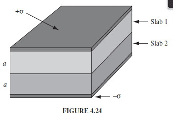

I have been looking everywhere for a clear explanation for the following: How do I know which way to integrate the electrical field, when I'm looking for the potential between to points?
Example:
Figure 4.24: a rectangular block of two stacked dielectric slabs, Slab 1 on top and Slab 2 below, each of thickness a, with a conducting plate of charge +σ on top and -σ on the bottom.
I have to find the potential between the top conducting plate and the bottom conducting plate. Assume that i got an expression for the field in both i linear dielectric slabs. My book says:
$$V = \int_\mathcal{O}^r \vec{E} \cdot d\vec{l}$$
However how do I translate that. Let's forget anything about the actually expression for ##\vec E##. Obviously we are going from ##0## til ##2*a## or the other way around. What dictates the path? I know what the answer to the assignment I'm doing is, but I do not see why my result (which is the same but negative) is wrong. It has something to do with the minus in front and the reference points. Can someone please clarify, because this has been driving me nuts for weeks now.
(The right answer comes from integrating from ##0## to ##2*a##)

For an EMF with an electric field ## \vec{E} ##, the voltage ## V=+\int \vec{E}_{induced} \cdot dl ##. For an electrostatic potential ## V=-\int \vec{E} \cdot dl ##. ## \\ ## The reason for this is arguably that in the case of an electric field from an EMF in a conductor, there is necessarily an electrostatic field that gets generated that is equal and opposite the Faraday electric field, in order to keep the current from becoming infinite. Instead, the total electric field must nearly vanish in the conductor.

EMF ## \mathcal{E}=-\frac{d \Phi}{dt} ## is known as an induced/Faraday EMF, where voltage ## V= \mathcal{E}=+\int \vec{E}_{induced} \cdot dl ##.## \\ ## (If you compute the voltage coming from an inductor, getting the correct sign can be important to have the calculations be completely consistent). ## \\## For the electrostatic potential ## V=-\int \vec{E} \cdot dl ##, which is also a voltage, the electric field integral gets a minus sign.

You need to show more detail, but then, it really belongs as a homework problem in the homework section. ## \\ ## I'm surprised you are already seeing a capacitor with dielectric layers, but they have yet to teach you about the Faraday EMF, which is caused by changing magnetic fields, in the physics class that you have.

We are using Griffith 4. Edition. Dielectrics is the last part of electrostatics, before magnetism is introduced. And yea I'd didn't really want help with the assignment itself as much as figure out what I'm missing about the potential.
It's about electrostatics. So don't worry about induction and electromotive forces yet. The integral form is a bit more complicated than suggested by @Charles Link anyway.
As for the question asked in the OP you don't need anything of this. It's a macroscopic electrostatic problem. I guess the dielectrics in the capacitor are simple homogeneous material, and you can use the linear approximation, i.e., the equations read
$$\vec{\nabla} \cdot \vec{D}=\rho, \quad \vec{\nabla} \times \vec{E}=0, \quad \vec{D}=\epsilon \vec{E},$$
where ##\epsilon=\epsilon_{\text{rel}} \epsilon_0## is constant along each of the slabs.
Then the usual approximate treatment is to assume that the extension of the plates is very large compared to their distance. Then you can treat the fields as homogeneous in each slab. Then you get the fields by making this ansatz and using the continuity of the tangential components of ##\vec{E}## and that the jump of the normal components of ##\vec{D}## are the free charge-area densities along the surfaces of the slabs.
