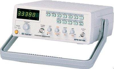

Yes, that helps. So it sounds like you can just use a bench-top signal generator to make the AC current that you drive through the electromagnet coil. What equipment do you have available to you for this?
http://www.lead-man.cn/anli/xhfsq.jpg
I have no equipment whatsoever and zero knowledge about how to make one. I suspect I will have to find someone locally (Edinburgh, Scotland who could provide such.
Okie dokie. Look for somebody with simple EE lab resources, like the signal generator shown above. If you can say more about your application, we may be able to offer more guidance. :smile:

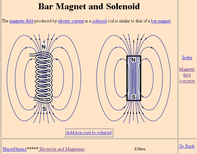

Before you pile in and make this thing, it would be a good idea to say what the application is and to make sure that an electromagnet is actually what's needed.
Might be worth brushing up on the basics here...
http://hyperphysics.phy-astr.gsu.edu/hbase/magnetic/elemag.html

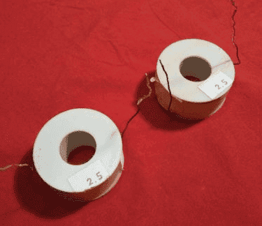

You might find suitable secondhand solenoid or inductor coils someplace .
eg http://www.ebay.com/itm/Two-2-5-mH-Air-Core-Inductors-1-2R-with-free-shipping-/322808916088?hash=item4b28e92878:g:SlcAAOSwEQFZqzea
Or buy a spool of wire. As long as both ends are available you won't have to wind it. Then get or make a core to fit in the spool.
