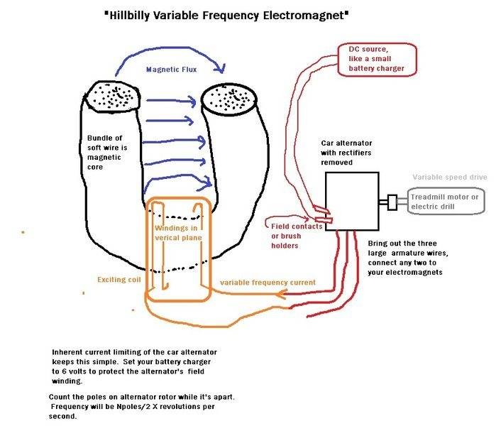

For a home experiment that's easy to construct from readily available stuff,
i think i'd suggest
soft black iron wire from the lumberyard for a core. The black oxide gives a little insulation and the small diameter approximates laminations.
Make a bundle and wrap it with tape , bend it into a U shape
Wrap a few hundred turns of copper wire around the bundle.
Pillage an old car alternator for a source
these old Mopars are dirt cheap and simple, no internal regulator and both brushes wired to the back.
Hmmm a circle might work better than a "U" shape..
Good Luck
View attachment 213035Hmmm a circle might work better than a "U" shape..
Good Luck
Thank you. Your explanation is clear. I wll see if I can implement it.

  • #46
Well, please let us know what you discover.
Many of us have grandkids too...
in case you use that sketch ---
You could wrap your copper turns around the whole length of your core there's no need to make them like the donut i showed.
And
Core in shape of big circle with a gap would concentrate flux in the gap.
With no idea what you're up to i don't know what geometry you need.
That 1892 book shows a lot of the experimental apparati the old timers used trying to figure things out. You'll find they experimented with bundled wire cores...
that's just one basic approach to achieve what i think you asked.

The car alternator i suggested requires no electronics knowledge
and would let you excite the electromagnets simultaneously
or synchronously with 1/3 cycle of phase difference.
But it lacks the precision and easy adjustability of a function generator.
