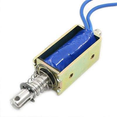

Can you say more about the application? For an attractive force, can you just use a solenoid actuator of some sort?
https://www.tinkery.com.au/wp-content/uploads/2017/04/dummy-solenoid.jpg
Photo of a push-type solenoid actuator with a gold-coloured rectangular steel frame, blue-wrapped coil, two blue leads, and a spring-loaded metal plunger with a clevis tip.
  • Photo of a push-type solenoid actuator with a gold-coloured rectangular steel frame, blue-wrapped coil, two blue leads, and a spring-loaded metal plunger with a clevis tip.

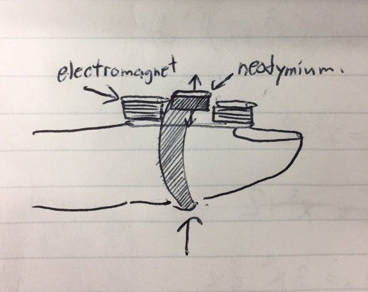

I can see a number of problems, some pretty significant.
@kolleamm -- can you post a sketch of your initial design idea? (use the UPLOAD button in the Edit window to attach a PDF or JPEG file) It would be good to see how you envision using a permanent magnet and a coil in a force-feedback glove. Presumably the glove should make the user feel like there hand is closing on an object of some size, for VR movement of objects, etc.?
Depending on how you manage the magnetic path around those high-power permanent magnets, you could end up with problems associated with those fields going places that do not react well to such fields. Can you say what a couple of those places might be? :wink:

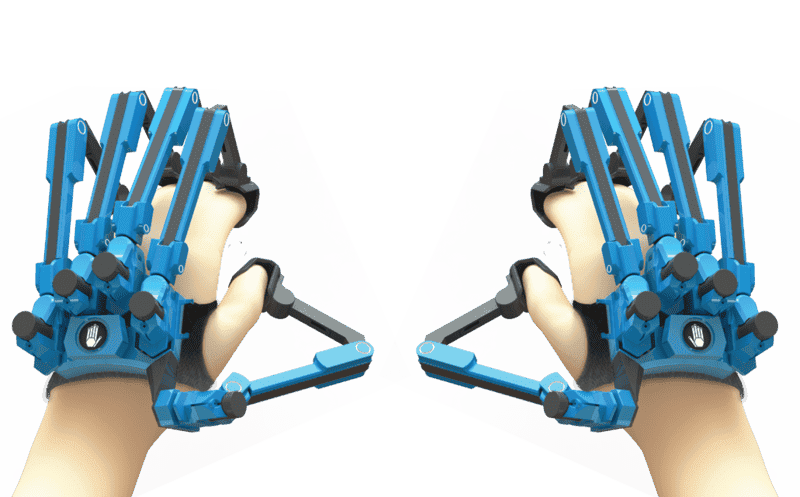

A current design approach for reference: https://cdn.shopify.com/s/files/1/2482/8512/files/TwoHands_800x640.png?v=1514890498
Pair of blue and black exoskeleton force-feedback gloves shown on two hands, with articulated finger linkages and a hand logo on the back of each wrist unit.
  • Pair of blue and black exoskeleton force-feedback gloves shown on two hands, with articulated finger linkages and a hand logo on the back of each wrist unit.

Thank for your reply, the application is indeed for Vr. Here is a rough sketch of how it should work. An electromagnet and a magnet is placed on a finger. The forces between the electromagnet and the neodymium magnet causes a strap to either tighten or loosen. That's pretty much it.
  • Hand-drawn sketch of a mechanism: two electromagnet coils labelled electromagnet sit on a horizontal band, with a neodymium magnet labelled neodymium above a curved strap, with up and down arrows showing movement.

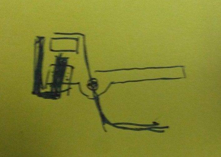

I don't think that this application really requires a permanent magnet. Your problem is, that in this configuration you need a pushing force, right? Then just transform it to pulling force.
Rough hand-drawn sketch of a lever arrangement: a solenoid-like coil on the left pushes a horizontal arm pivoting about a circle, with a rod extending downward from the pivot.
(Sorry, my drawing skills are... )
jim hardy said:
IF ... you're not limited by heat dissipation in the coil
Well, maybe for this one application he is... :biggrin:
  • Rough hand-drawn sketch of a lever arrangement: a solenoid-like coil on the left pushes a horizontal arm pivoting about a circle, with a rod extending downward from the pivot.
