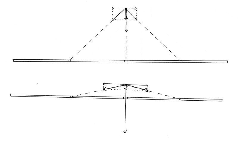

In the image I attached, there is a proton between two parallel plates. Let's say the charge of the plates and distance between the plates result in a force of 2N on the proton. If F is constant that means no matter how close the proton becomes to the the negative plate the force from the negative plate alone has to be less than 2N. That doesn't make any sense to me, I would think that as the proton becomes closer to the negative plate the force would increase exponentially resulting in a much greater force than 2N

The force on the proton from the piece of the plate that is directly underneath it does increase as the proton comes closer to the plate. However, the net force from the pieces of the plate that are off to the sides decreases. To see this, consider two pieces of the plate at equal distances from the center, on opposite sides of the proton. As the proton comes closer to the plate, the forces from these two pieces become more nearly opposite in direction. Their horizontal components cancel, and their vertical components become smaller and smaller.
It turns out that as the proton comes closer to the plate, the sum of the forces from all the off-center pieces decreases rapidly enough to counteract the increase in the force from the central piece of the plate, so the grand total force remains constant. To prove this, you have to use calculus.
Added to clarify: My diagram does not show two plates, but rather two situations with one plate, with the charge located at different distances. For an idealized charged plate that extends to infinity in all directions, the electric field (and force exerted on a charge) is uniform with distance. Two infinite, oppositely-charged plates exert equal forces (in the same direction of course) on a charge between them, no matter where the charge is located.
