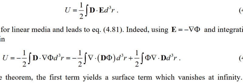

Electrostatic energy involves a volume integral and a surface integral
The question is how to apply this formula to a finite space in which case the 1st term (surface integral) won't vanish. Let's apply to a capacitor and enclose the capacitor by a closed surface. Calculate the energy integral in this closed volume, then the first surface integral does contribute. How to understand the contribution of the nonzero first surface integral term?

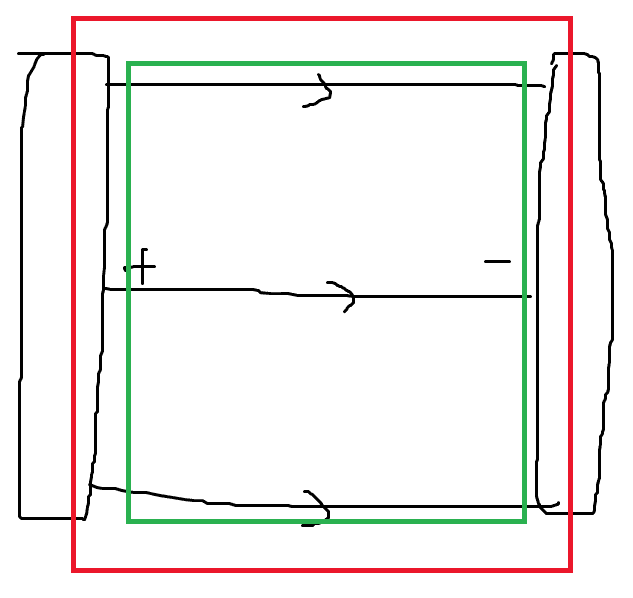

Let's consider two volumes we will calculate the energy volume integral in enclosed by the red and green surfaces respectively. Assume both surfaces are infinitely close such that the red surface just encloses all the electric field and the green surface is just within the two parallel plates. Then the energy integral in the two different volumes (red and green) will yield different results in that the surface integral will come into play on the green surface. Correct?

I am not sure but if I did all the math correctly , in the case of the capacitor (and taking the volume K to be the volume enclosed by green line in post #8) we have that
$$I_1=\frac{1}{2}\oint_{\partial K}\Phi\mathbf{D}\cdot \hat n dS=\frac{1}{2}QV$$
$$I_2=\frac{1}{2}\iiint_K\Phi\nabla\cdot\mathbf{D}dK=0$$
The first integral is 1/2QV check post #5 (##Q=\sigma A## ,##\Phi_2-\Phi_1=V## where V the potential difference between capacitor's plates)
The second integral is 0 because ##\nabla\cdot\mathbf{D}=0## because D is constant in magnitude and direction, in between capacitor's plates.
So all the contribution comes from the first integral actually in the capacitor's case.
So, in my opinion, it depends on the case which integrals contribute, it might be both, one or the other.
Divergence theorem doesn't hold for the volume enclosed by the red line, because D has a discontinuity (jump) at the capacitor's plates (it is constant in between the plates and at the interior surface of the plates, but it becomes zero within the plates (if they have thickness) and outside the capacitor). So you can't convert the first volume integral to a surface integral in this case.

1. Start with $$U=-\frac{1}{2}\int\vec\nabla\cdot(\vec D\Phi)+\frac{1}{2}\int\Phi \vec\nabla\cdot\vec D~d^3r.$$2. Note that from Maxwell's equation, ##\vec\nabla\cdot\vec D=\rho##.
3. There is no charge between the capacitor plates, therefore the second term on the right is zero.
4. Do the first term integral to convince yourself it gives the energy stored in the capacitor, ##U=\dfrac{\epsilon_0A}{d}(\Delta \Phi)^2##. That's its physical meaning.
Start with ##\Phi=Ax+B##, match boundary conditions to get the constants and use ##\vec D=-\epsilon_0\dfrac{d\Phi}{dx}~\hat x##. It would be instructive to do the green volume integral and then transform it to a surface integral and do that. The red volume integral works but the corresponding surface integral doesn't because the field is zero at the red surface and provides no information about what's inside it.
I think that's what @Delta2 meant when he said that you can't convert the volume integral into a surface integral. You can, mathematically, but physically you shouldn't. The red surface boundary is useless for figuring out the contained electrostatic energy because all field lines start and stop within it and you can't distinguish zero from non-zero contained energy. In contrast, the volume integrals and the green surface integral allow you to "peek" inside and use the field value tp find the electrostatic energy.
That's why I said that you can't convert the volume integral to the corresponding surface integral, they are not equal, so divergence theorem doesn't hold.
