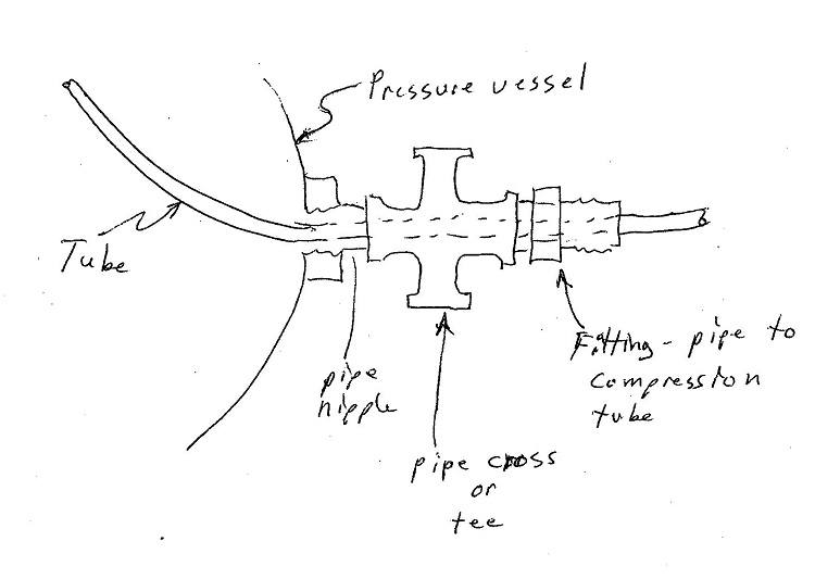

I am a qualified inspector for pressure vessels, and hydraulic testing means filling the tank with liquid (water) to the top of the tank, than using a hand pump raizing the internal tank pressure up to 150% of the design pressure for 30 min.
Most of the designed pressure vessels I've tested are equipped with such openning at the top (plug/pipe/valve..) that can be open/dismantled to enable releasing the air from the tank during filling it with water. Few tanks (vertical/horizontal) are not equipped with such opennings at the top (the opennings are locatted below the top e.g at the shell of vertical tank, so during filling the tank with water - the inside air can be released as long as the openning is above the water level, once the water level pass the openning - the air is trupped between the upper water level and the (inside) top of the tank and could not be released = trupped bubble air).
The ideas to redesign or turn the vessel upside down so the hole is at the top are impractical when it is already installed at the plant..

For compressed air, I would consider a flexible 1/4” silicone tube, with a float of closed cell foam, maybe neoprene. Clear Vinyl Tube, CVT, would be cheaper than silicone but less flexible.
I would fit a 1/2” Tee adaptor at the access point. The test water would enter and drain through the stem of the Tee. A 1/4" metal tube would pass freely through the cross of the Tee into the tank where it is connected to the flexible tube. The metal tube would have a compression fitting to the outer end of the Tee, and a valve outside the vessel. That valve would control the air bleed during the venting.

I think the concept is correct, but it would be better if you can attach a sketch to clarify the tubes connections ( 1/4” silicone tube & 1/4" metal tube ) and the way there are inserted ( with a float of closed cell foam ) into the ∅1/2" opening of the tank. Does a small (less than 1/2") float is sufficient to raise the tube?
Also, I am not sure I understood your compression fitting to the outer end of the Tee recommendation, sketch would be helpful.🤔
Here's a sketch:
A pipe cross provides connections for filling and a pressure gauge. The steel air vent tube is bent so that it goes to the top of the tank. Loosen the compression fitting so the cross fitting assembly can spin, install the assembly, then tighten the compression fitting. Fill the tank until water runs out of the tube, then close the valve in the tube (not shown). Run the pressure test.
This is a simplified sketch - the compression sleeve and nut are not shown. The fill line is not shown. The shutoff valve in the tube is not shown.
Steel tube is cheap, so you can make a custom assembly for each different tank size. You should be able to use 1/4" OD steel tube in 1/2" pipe fittings. That tube size is easy to cut and bend by hand. You need to make sure that the tube is properly aligned inside the tank, possibly an external bend in the same plane as the inside bend.
As @jrmichler shows in the diagram, with such a small tank there is no need for a flexible tube and float. The flexible tube and float would only be needed for large industrial reservoir tanks where the access port is some distance vertically and horizontally from the high point.
I would use annealed copper tube that is easy to bend into a long gentle curve. Cut a slight Vee notch in the end of the tube so it cannot accidentally seal flat against the upper inside surface of the vessel.
The tube might be extended for larger vessels by sliding a length of clear vinyl tube onto the end, maybe with a float.
Place a swivel connection where the Tee assembly connects to the vessel, not at the compression fitting. I would use a Tee connector so I could be sure of the orientation of the internal tube. You should be able to hit the inside top of the vessel with the tip of the tube, and feel on the outside where it is contacting the inner surface.
The compression fitting should have a brass olive that clamps onto the tube. Normally the tube end would rest against an internal step in the fitting, but since in this design the tube passes through the assembly, you will need to carefully drill or bore out that step without damaging the olive seat. The olives should not be reused once they have been clamped onto a tube.
A valve to control the venting of air will be connected to the external end of the tube. Close that valve when water flows clear without air bubbles.
Check that the pressure ratings of the Tee, compression fittings, and valve all meet the required 20 bar or 300 psi. Most low cost pipe fittings will fall short of that. For higher pressures I would select all parts from the range of standard 1/2” and 1/4" BSP hydraulic fittings.
