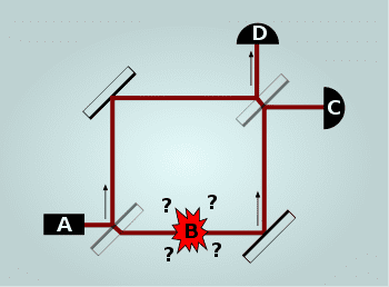

When a photon passes through the first semi-transparent mirror, it turns into a superposition of photons traveling along the upper and lower paths. In MMI this means that two "parallel worlds" appear...
https://en.wikipedia.org/wiki/Elitzur–Vaidman_bomb_tester
Diagram of a Mach-Zehnder style interferometer with source A, two beam splitters, mirrors, a bomb marked B with question marks around it, and detectors C and D.
In the Elitztur-Weidman experiment there are bombs that are triggered by a single photon hitting their detector, and with some probability you can find out that the bomb is working, despite the fact that it did not explode.
I'm trying to formulate how this experiment can be described in the many-worlds interpretation. When a photon passes through the first semi-transparent mirror, it turns into a superposition of photons traveling along the upper and lower paths. In MMI this means that two parallel worlds appear (I do not like the word "parallel" but there is no other yet), in the first one the photon goes along the upper path, in the second - along the lower one. In the first world the photon hits detector D or C, in the second it is absorbed by the bomb and the detectors see nothing. Yet it didn't become clearer; probably, in order to move forward, you need to figure out what happens to the photon or superposition on the second semitransparent mirror. It is written that the superposition interferes with itself and is detected in C; what is the correct name for the reverse transformation of a superposition into a single reality - decoherence or destructive interference?
In the Copenhagen interpretation, the experiment can be stated as follows. The bomb is an observer, the hit of a photon on its detector is a measurement process, i.e. wave function collapse. As a result of the collapse, the superposition turns into a single photon flying either along the lower path or along the upper one. If on the top - it is detected on D and so we find out that the bomb worked. If I'm not confused, Wikipedia says that if a superposition of photons hits the second mirror, then it decoheres and a photon is always detected at C; if a photon flying along the upper path hits, then it is reflected and detected either on C or on D. I did not find in the article what will happen if the photon passes only through the lower path. Maybe we are talking about the fact that this is impossible - if the bomb is faulty, then there will always be only a superposition?
It is still unclear to me how such an experiment is possible from a technical point of view. In order for the superposition of two photons to merge again into one photon, is it necessary that the first and second components of the superposition meet exactly at a single point in space? I mean that if, for example, in this setting, the length of the horizontal path is increased by one and a half times, and the length of the vertical path is not changed, then the superposition will not merge on the second translucent mirror, because the top and bottom photon will not meet in the same place? Then it turns out that for a correct experiment it is necessary to adjust the geometrical parameters of the installation to within an atom, very strange.
Just in case, I will state, as it is written in Wikipedia: if the bomb is in good condition, with a probability of 50% the photon will not be detected (the bomb exploded), with a probability of 25% it will be detected on C (as I understand it, the bomb also exploded) and with a probability of 25% it will be detected on D (the bomb is working but did not explode).
There are a number of misconceptions in your post. The main one is that there is only every one photon and never two photons. A superposition does not increase the number of photons, but describes a spatially more complicated state.
In general, photons don't behave the way you imagine. You might want to start by reading Feynman's introduction to QED:
https://www.goodreads.com/book/show/5552.QED

1) Do I understand correctly, that if there is no first mirror and bomb, and the photon always follows the lower path, then detector C is triggered with a probability of 50%, detector B with a probability of 50%? And the same if the photon always follows the upper path?
2) If there is no bomb, after the second mirror, two “parallel worlds”, in which the photon goes towards D, “annihilate”?
3) What formulas describe this annihilation?
Yes, if you meant “D” instead of “B”. If you really do mean “B”, then no - B will always trigger, and the photon will never reach C or D.
That will depend on how we arranged to always send the photon on the upper path, but if we did so by replacing the bottom left half-silvered mirror with an ordinary full mirror like at the top left and bottom right ones…. C is triggered with 50% probability, D is triggered with 50% probability.
No, we just have a quantum superposition in which the amplitudes for the path to one detector interfere destructively. We don’t get multiple worlds until we have an irreversible outcome. So a photon enters the apparatus and soon after we have three worlds, one for each possible outcome: the bomb has exploded (if it is there and not a dud), detector C has triggered, or detector D has triggered.
You’ve already linked the Wikipedia article on the Mach-Zehnder interferometer - it has the the math that describes the superposition and how to calculate the probabilities of the different possible outcomes.

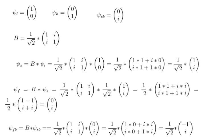

I have written the formulas, please look and say whether they are correct:
Handwritten-style equations of two-component state vectors and a beam-splitter matrix B = (1/sqrt(2))(1 i; i 1), applied step by step to states labelled psi_l, psi_s, psi_f, psi_sb and psi_fb.
Here Ψl is the wavefunction of the electron moving at the lower path, Ψh correspondingly the higher path, Ψs is the superposition after the first beam splitter, Ψf the superposition after the second beam splitter, Ψsb the Ψs after detonation of the bomb, Ψfb the superposition after the bonb and the second beam splitter.
They are not even wrong, because you don't explain what those formulas describe. Besides, why do you denote the product by a star, are you a programmer or something?
I am a programmer. How the product should be denoted?
Ψl is the wavefunction of the electron moving at the lower path, Ψh correspondingly the higher path. When the electron passes the first beam splitter, Ψl is multiplied by B and the superposition Ψs appears. When this superposition passes the second beam splitter, it is multiplied by B again, and it is shown mathematically how the Ψl component (the higher digit in the vector) dissapears (this means that the D detector does not receive photons). Ψsb is Ψs where the Ψl is made zero because of the detonation of the bomb. When Ψsb passes the second beam splitter, it is multiplied by B and Ψfb appears (and since Ψfb contains the Ψl component, the D detector can receive photons).

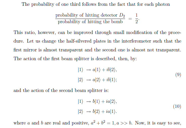

I have read the article of Elitzur, and one moment should be clarified. The authors describe the procedure for improving the efficiency of the experiment (to get a better percentage of good unexplided bombs):
Printed page of text with equations: the probability ratio of hitting detector D2 to hitting the bomb equals one half, then beam splitter actions (9) and (10) with coefficients a, b, ia, ib, where a^2 + b^2 = 1 and a >> b.
But if the first mirror is almost transparent, this means that most of the photons will follow the lower path and accordingly detonate the bomb? Maybe the authors got it slightly wrong?
No, you haven't, you've posted them in an image. That is not allowed. Please use the PF LaTeX feature to post equations directly in the thread.
Sorry. Here they are:
##\psi _{l}=\begin{pmatrix}1\\0\end{pmatrix}## ##\psi _{h}=\begin{pmatrix}0\\1\end{pmatrix}## ##\psi _{sb}=\begin{pmatrix}0\\i\end{pmatrix}##
$$B=\frac{1}{\sqrt{2}}*\begin{pmatrix}1 & i\\i & 1\end{pmatrix}$$
\psi_{s}=B*\psi_{l}=
1 & i\\
i & 1
\end{pmatrix}*\begin{pmatrix}1
\end{pmatrix}
1*1+i*0 \\
i*1+1*0
\end{pmatrix}=
1\\
i
\end{pmatrix}$$
\psi_{f}=B*\psi_{s}=
1 & i\\
i & 1
\end{pmatrix}*
\frac{1}{\sqrt{2}}*
\begin{pmatrix}1
i
\end{pmatrix}
\frac{1}{2}*\begin{pmatrix}
1*1+i*i \\
i*1+1*i
\end{pmatrix}=
1-1\\
i+i
\end{pmatrix}
\begin{pmatrix}
0\\
i
\end{pmatrix}
\psi_{fb}= B*\psi_{sb}=
1 & i\\
i & 1
\end{pmatrix}*
\begin{pmatrix}0
i
\end{pmatrix}
1*0+i*i \\
i*0+1*i
\end{pmatrix}=
-1\\
i
\end{pmatrix}$$
