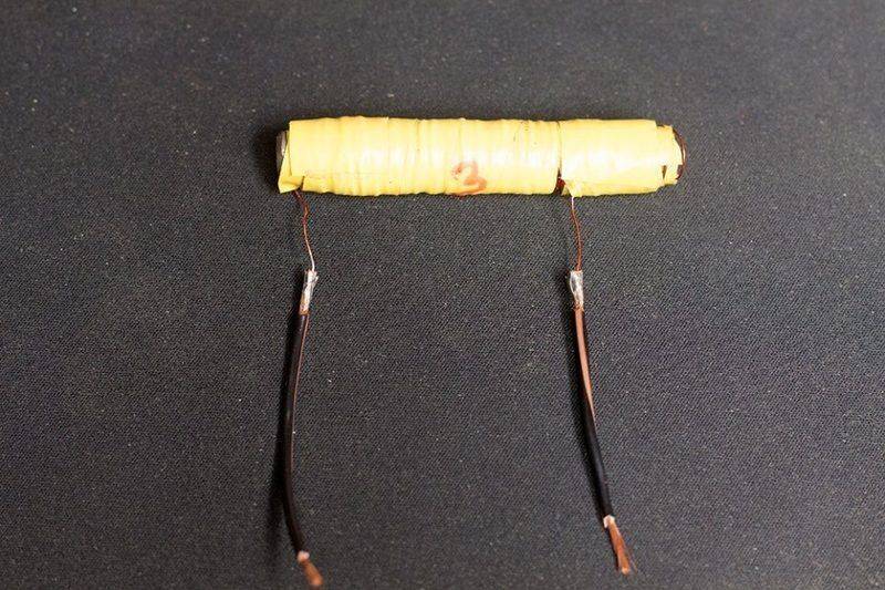

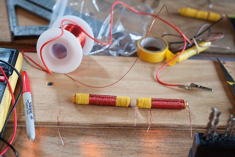

I just tried my first 3x layer coil (90+90+90=270 wraps of magnet wire around the core). I'm noticing drop off in efficiency compared to the MASSIVE boost from 2 layers, but it's still a solid gain. The 3x is so strong however that unless I'm pushing away from a distance, the coil jumps out of the groove and kisses the magnet. I've already planned for that with a bag of zip ties, but I'll need to actually zip tie the 3x coil into to track before I can even play with it.

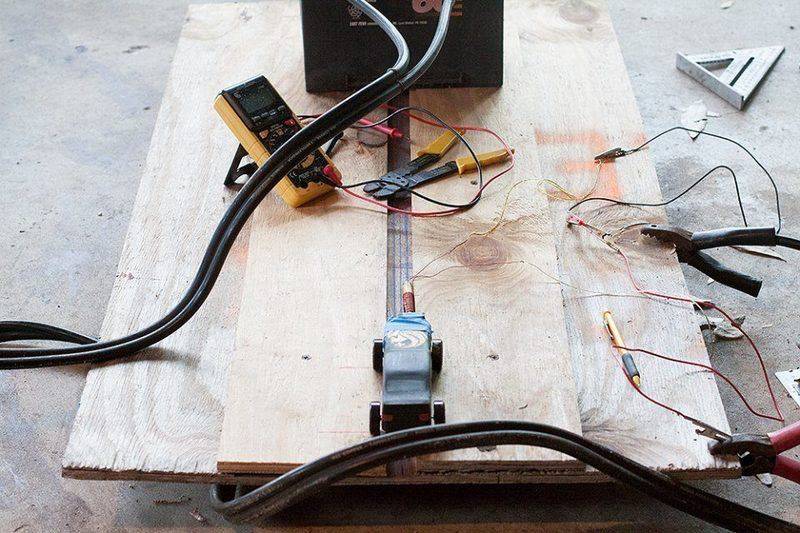

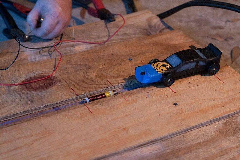

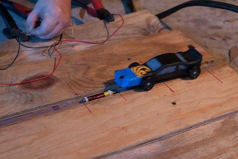

This was ~ midnight last night when my first working coil actually moved the car. I promise I'll give you a video walk around of the final product when it's complete. I'm actually in a team of 4. So far I've done 100% of the work but I decided to hold off on mapping out the individual coil strengths for the shoe and bring the whole contraption with my new found knowledge of how to make it work into class tomorrow. I'll let the rest of the team help me plot the strength of my 5 current coils (90 wraps x3, 180 x1, 270 x1). And probably have them each make a coil of their own. They aren't slackers, they just aren't good at dumpster diving for parts. I'm sure I'll add more coils as well but for now I want to explain to the rest of the guys the who/what/where/when/how of the thing.
We are in a strange physics pilot program which the syllabus claims as "no lecture no test" physics. We meet Monday, Wednesday, Friday for 2 hours and the entire class is a lab. It started at Harvard and my university is one of several others trying it out. They drop large practical projects and/or papers like these in our laps with a sink or swim attitude. The idea is that instead of spacing out in a lecture you'll be forced to teach yourself and make creative working examples of the lessons or you simply don't pass. Seems to be working pretty well. I sure know a hell of a lot more about electromagnetism tonight than I did two weeks ago. There are 16 groups and each is doing a project on electromagnetism. I know someone is making a rail gun, which was my first though but the rest of my group had reservations of bringing a "gun" to school. Hah. Another group who's proposal I overheard is making a hand crank generator. I don't know what the other 13 groups are doing. One my group's members said, "lets move a car down a track", and here we are. The next (and last) project will focus on optics.
We are allowed to use any resource imaginable with the single exception of Chegg, so coming to forums like this for advice isn't frowned upon. In the end you either make it work or you don't. Projects are graded on a scale of 0-3.
0 = you didn't even try
1 = you tried but it wasn't very impressive for whatever reason
2= exactly what they were looking for, good job
3 = exceptional (it wouldn't be uncommon for there not to be any 3's though I made one for a paper describing the electrostatic mechanisms of the nervous system)
All 2's is an A for the course, but a 3 can offset a 1. If you get a single 0 the highest grade possible is a C regardless of how many 3's you may have and two 0's is automatic failure.

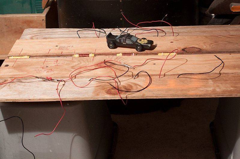

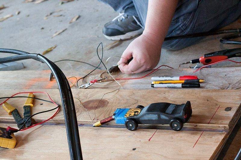

This was tonight, beginning to map out the shoe. I complete the first coil as an example to my teammates but I'm going to walk them though doing the others themselves. I'll actually apply the sheet metal either tomorrow night or Tuesday, but I want them to at least play with the battery and draw the lines if nothing else. I'm using the car battery exclusively now by the way. Went to WalMart tonight and picket up some more cheap alligator clips, the ward off any extra resistance from touching the speaker wire to jumper cables. I was getting tired of arc welding the wires over and over anyway.
I never intended the permenant magnet's final resting place to be taped to the grill of the car. I'll move them back, probably toward center of mass. The measurments are still valid though, as the magnets frame of reference won't change. Just move the lines proportionally to match. Love your idea about insulating the shoe. I'll probably just use one long strip of alluminium with electrical tape representing where to cut, just dial each coil in one at a time until it's right. Then cut and wire each piece of the shoe's track afterward.
Notice in the above image the coil is zip tied under the track. This was what happened before that development:

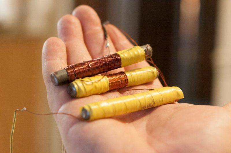

My first 3 coils, I've sense gotten much better. I'll have to get a picture of the new ones. Anyway, thanks again for all your help. I'll make sure to update my progress when I have progress worth updating. I'm feeling pretty confident at this point. It's going to happen, and it's going to be awesome.

I think I'm going to dismantle two of the 3 90-wrap coils, saving one for pass around demonstration, and convert them to 180-wraps. I just don't feel like hack sawing and filing more cores at the moment. I'll be using brand new magnet wire now, as I think the prototype coils from salvaged wire I've made thus far have served there intended purpose of teaching me how to do it properly. I hope to break major ground today.

Wound the brand new coils before dinner and just hooked them up to real juice aside from just an ohm meter. I'm getting 14" of push in a single direction from a single electromagnet and the track is only 3' long. The original plan was to push the car up an incline, but I only have a tabletop for the display. One of the group members suggest I use a break magnet to serve as an invisible fence and I think thought that was a good plan. So this thing is going to be moving pretty damn fast, and at the last second it will come to a halt.

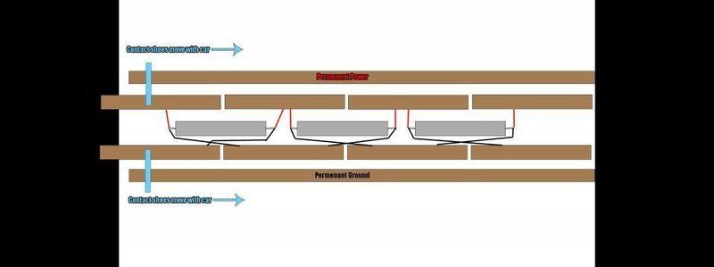

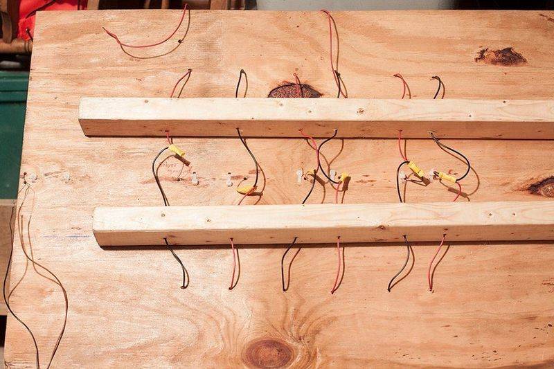

Coming right along...Ignore some of the wording, I'm just copying and pasting from my Facebook post from a couple seconds ago.
Bottom circuit route, power and ground coming from each coil lead so they can work in both directions to pull the car in and then push it away when it passes.
The leads were too short to reach a crimp under the plywood so I got to show off my soldering skills. Soldering 3 wires together, one of which (the magnet wire) doesn't take well to soldering, is a nightmare. I started getting mad at my lack of 3 hands. Even that would be tough, it's a 4 hand job. So I just crimped.
Dismantled the 2nd and 3rd coils I made in the prototype phase. I kept the 1st for sentimental reasons. Used the cores from those 1 layer coils (which also had used wire) to make these 3 layer coils. Got lazy and didn't feel like spending half an hour hack sawing more cores. The brand new wire is much thicker than the old wire I was using. This mean less wraps per layer. The older wire feels like wrapping a spiderweb by comparison.
These are pushing my car 13 inches 1-way. When everything is hooked up they will be working both ways. The track is only 3 feet long, so the car should be moving pretty quick once you add them all together automatically.
That automatic part is what I'm working out now. I want to flip a switch and have everything just...work.
