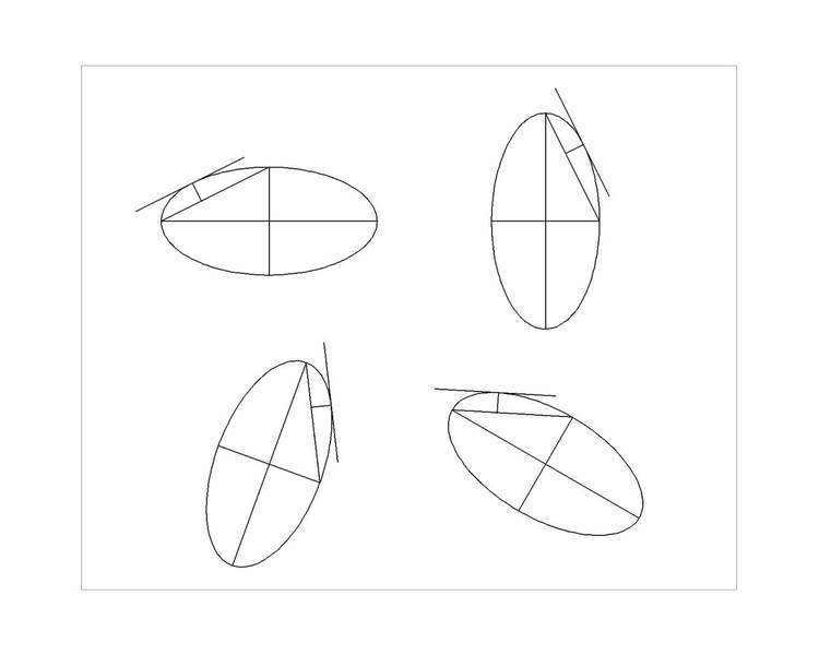

It is clear that, given the length of the chord and the distance to the parallel tangent, there can be only one solution (excluding the mirror image of the ellipse which for all practical purposes equates to "one and the same").
I have no values for a or b or C or anything that I can use to relate back to the standard equations. No line slopes to work with, so where can I go from here?

Not true. There are an infinite number of ellipses that fit that description. However, there are only 2 "standard" ones (with their axes parallel to the x- and y-axes).
(See attachment)
  • Four ellipses in different orientations, each with a pair of perpendicular axes drawn through the centre and a chord with a tangent line at one vertex, forming a right-angle marker at the tangent point.

Point taken. But if you're going to come up with an equation for this ellipse (and the coordinates of the foci), you'll need to narrow it down to just one ellipse.
My point is valid. There is not just one single answer. How can you come up with the coordinates of any point (foci, or the tangent point M in your picture) otherwise?

A "standard equation" for an ellipse describes a specific ellipse. For instance, the equation
[tex]\frac{(x-3)^2}{25} + \frac{(y+2)^2}{16} = 1[/tex]
describes an ellipse that has the following characteristics:
center at (3, -2)
major axis 10 units long, parallel to the x-axis
minor axis 8 units long, parallel to the y-axis
The equation describes THAT ellipse only; If you "tilt" that ellipse by ANY amount, you need to find a different equation to describe it.
The problem you posed doesn't define where the center of the ellipse is located on the Cartesian plane, nor does it define the angle of the major axis in relation to the x-axis. So, there is no single answer.
