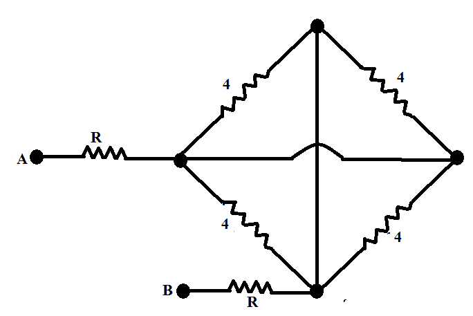

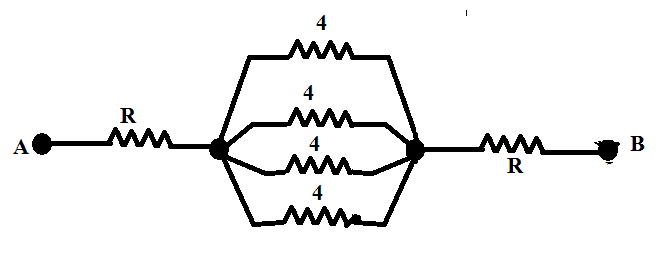

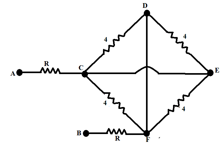

The discussion focuses on alternative methods for calculating equivalent resistance in a circuit, specifically addressing the use of wye-delta transformation. A participant successfully solved the problem using this method but sought additional techniques. Another contributor highlighted that by visualizing the circuit differently, specifically by flipping the upper half of the configuration, the four 4Ω resistors can be simplified, allowing for a more straightforward calculation. This approach emphasizes the importance of circuit visualization in solving resistance problems.
