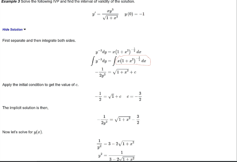

See attached
separation of variables
My interest is only on the highlighted part, i can clearly see that they made use of chain rule i.e
by letting ##u=1+x^2## we shall have ##du=2x dx## from there the integration bit and working to solution is straightforward. I always look at such questions as being 'convenient' questions.
Now to my question, supposing we had ##x(1+x^2)^{-\frac{1}{5}} dx## in the place of ##x(1+x^2)^{-\frac{1}{2}} dx##
How would we handle this?

You would handle it the same way that I would suppose the original integration was done: Sub ##u = 1 + x^2## and go from there.

I don't see that a simple substitution would work for this revised problem. For your 2nd example above, the expression in parentheses is ##1 + x^2##. Outside the parentheses you have something that is almost the differential of ##1 + x^2## (differing only by a constant multiplier). For a similar kind of substitution for your first example you would need the differential (or a constant multiple of it) outside the parentheses.

The easiest way to see it is to do it in two steps:
1. Let ##u = x^{1/2}##.
2. Then let ##v = u + 1##.
But you can come up with all sorts of ugly examples, and many of them do not have an actual solution. If your question is about integration techniques of
##\displaystyle \int \dfrac{x \, dx }{(1 + x^a)^b}##
you really need to put it in it's own thread.

What happened with the y' in the separation process( from top line to 2nd line)?
Check post ##8##. My interest is solely on the highlighted part of post ##1## in red.
