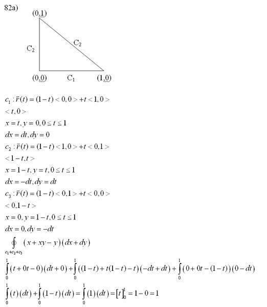

Find the simple closed integral of (x+xy-y)(dx+dy) counterclockwise around the path of straight line segments from the origin to (0,1) to (1,0) to the origin...
a)as a line integral
b)using green's theorem
Eq of line segment r(t)=(1-t)r0+tr1

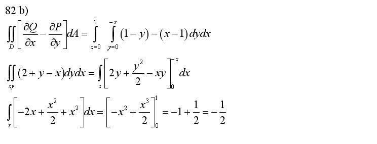

Greens Theorem states that Integral of Pdx+Qdy on a closed simple path will equal the double integral or area of dQ/dx-dP/dy (see the work I did)
See the pictures. The two were supposed to be equal, I just needed to show how to arrive at the same answer using both methods. The triangle shows the graph of the path, horizontal is x axis, vertical is y axis. The C2 on the left of the triangle should say C3, sorry. Also the first integral should read (1+y) not (1-y)
  • Handwritten-style worked solution: a triangle with vertices (0,0), (0,1) and (1,0) labelled with segments C1, C2 and C3, followed by parametrizations and the line integral evaluation of (x+xy-y)(dx+dy) around the closed path, yielding 1.
One obvious error is in saying that
[tex]\frac{\partial Q}{\partial x}= 1- y[/tex]
Q= x+ xy- y so
[tex]\frac{\partial Q}{\partial x}= 1+ y[/tex]
but it is written correctly in the next line so that's not the problem.
I notice you then integrate, in integrating over the area,
[tex]\int_{y=0}^{-x}[/tex]
Why is that? The upper boundary is y= x, not y= -x. It looks to me like you should be integrating [itex]2x+ x^2/2- x^2= 2x- x^2/2[/itex] with respect to x. That would give [itex]\left[x^2- x^3/6\right]_0^1= 5/6[/itex] rather than -1/2.
But that wouldn't give you the same answer for part a and b...
Why would that give y=x for the boundary. I looked it over again with my calculator, that upper boundary line (hypotenuse) is y=-x+1
however integrating that you end up with 2, which is still not the same as part a.
Yes, you are right about that- I misread your problem.
But, still, the integral should be from 0 to 1- x, not to just -x.
