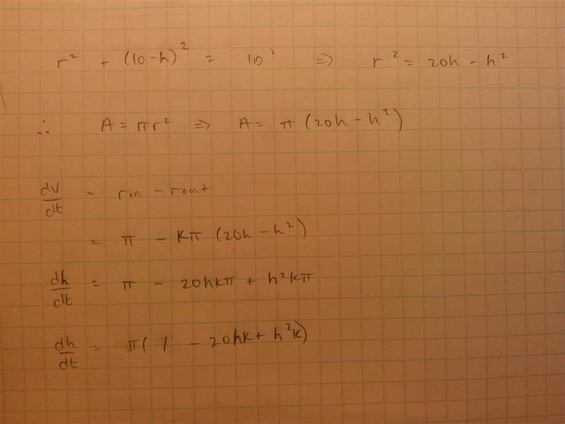

Handwritten derivation on graph paper: r^2 + (10-h)^2 = 10^2 gives r^2 = 20h - h^2, then A = pi r^2 gives A = pi(20h - h^2), followed by dV/dt = rin - rout and dh/dt = pi(1 - 20hk + h^2k).
Hey guys
So I have this problem I'm working on and I just can't seem to get too far with it. I've gotten half of the first part...I'm just having trouble integrating the equation I got...and I don't even know if the equation I got is right in the first place!
I set:
Rin = pi
Rout = pi(20h-h^2)
dh/dt = Rin - Rout
I'm trying to solve the DE right now but don't know how to proceed...
Any help would be great,
Thanks.

How about we try this:
We know from part (a) that [itex]A(h)=\pi(20 h-h^2)[/itex] and:
We can write:
[tex]\frac{dh}{dt}=\frac{dh}{dV} \frac{dV}{dt}[/tex]
and first without evaporation we have:
[tex]\frac{dh}{dt}=\frac{dh}{dV} \frac{dV}{dt}=\frac{1}{2\pi Rh-\pi h^2} \pi[/tex]
we can integrate that:
[tex]\int_0^h (2Rh-h^2)dh=\int_0^t dt[/tex]
and get:
[tex]Rh^2-1/3h^3=t[/tex]
and use that to figure out how long it takes to fill without evaporation.
Now with evaporation, we have:
[tex]\frac{dV}{dt}=\pi-kA(h)[/tex]
so substituting, we obtain:
[tex]\frac{dh}{dt}=\frac{1}{2\pi Rh-\pi h^2}\left[\pi -k(20\pi h-\pi h^2)\right][/tex]
Now the question is, can we integrate that and is it correct? Gotta' try things in math you know, and learn to tolerate making wrong turns. :)
