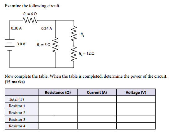

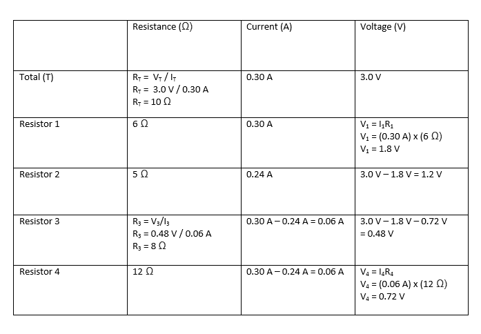

equations listed below in chart
here is my answer, i just need to know if I am doing this correctly, thanks :)[/B]
Looks good.
ok thanks for the quick reply :smile:
