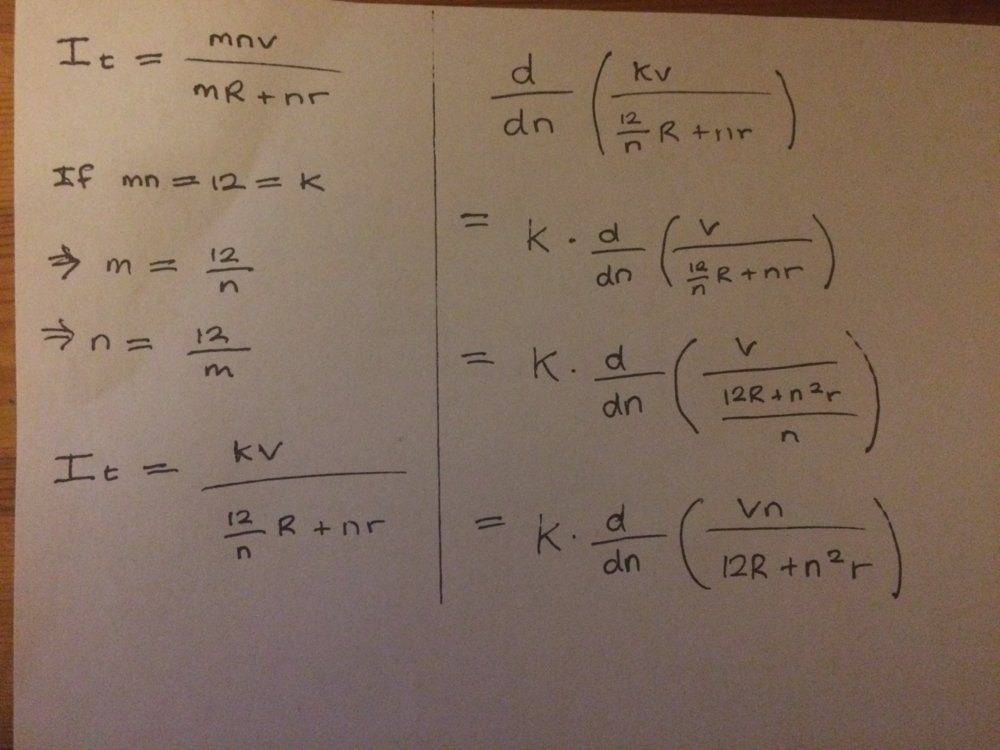

The product mn is fixed, so there is only one independent variable.

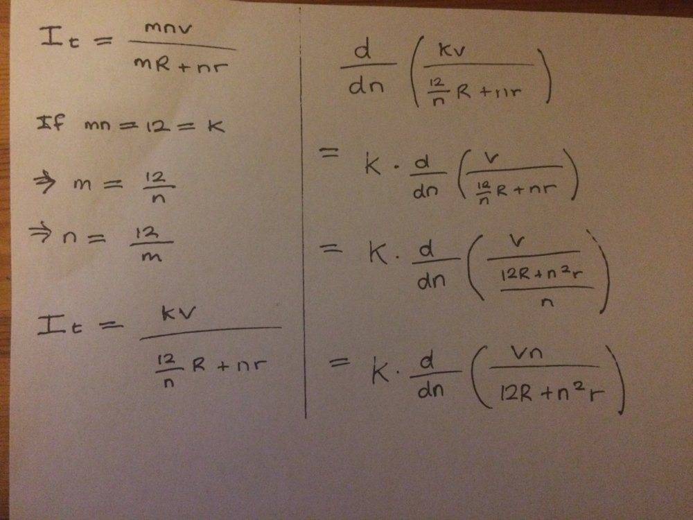

If product mn is fixed then it can treated as a constant which I'll label as k
Therefore I have total current = kv/mR + nr
What should I differentiate this with respect to?
Edit:
Would this be along the right lines? Where I differentiate with respect to n, set that derivative to zero to find n. Then subsequently get m by 12/n
Handwritten derivation: left column gives It = mnv/(mR + nr), with mn = 12 = k, leading to m = 12/n, n = 12/m and It = kv/(12/n R + nr); right column differentiates kv/(12/n R + nr) with respect to n, simplifying to k times d/dn of vn/(12R + n^2 r).
Edit:
Yes, that looks right. But why use K in some places and 12 in others?

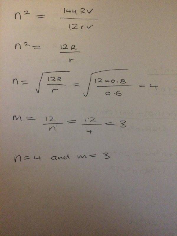

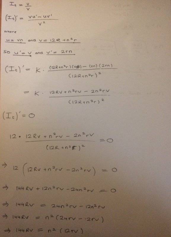

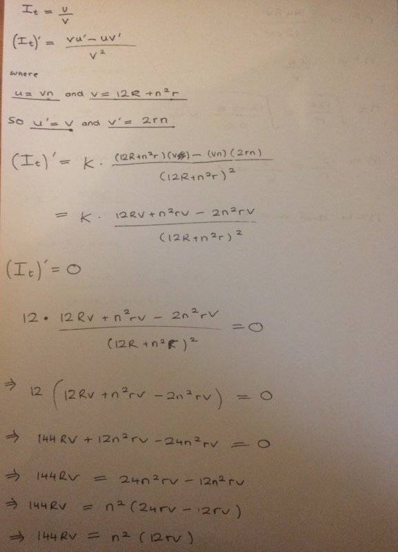

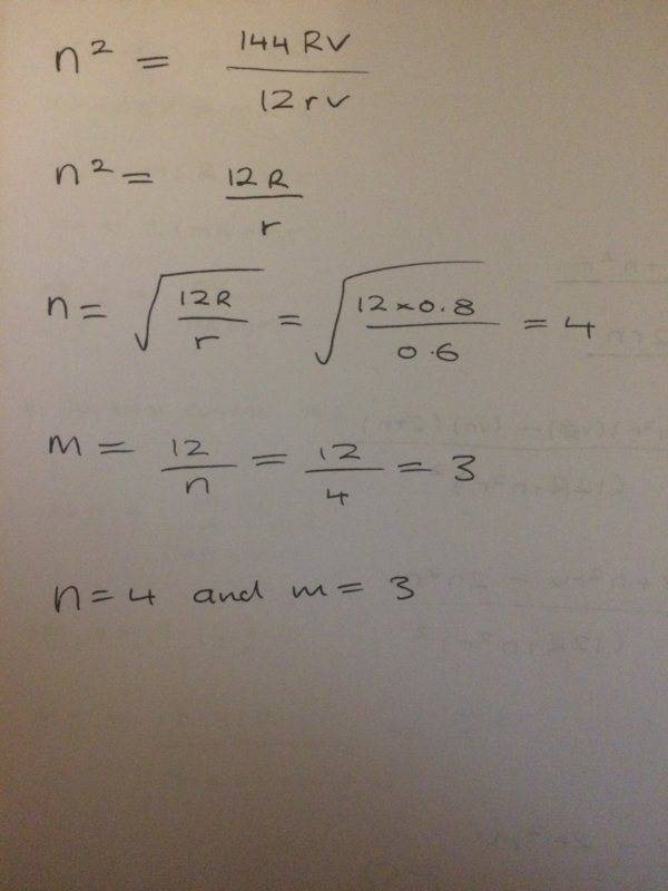

Yes sorry, should've stayed consistent and used k or 12 only throughout.
To differentiate the function I used quotient rule to do this and solve for n and m when letting the derivative be set to 0
And I do get n = 4 and m = 3
Handwritten derivation differentiating I_t = v/V using the quotient rule with u = vn and v = 12R + n²r, setting the derivative to zero and solving to get 144RV = n²(12rv).
Handwritten working on paper: n squared equals 144RV over 12rv, then n squared equals 12R over r, then n equals the square root of 12R over r, equals the square root of 12 times 0.8 over 0.6, equals 4, then m equals 12 over n, equals 12 over 4, equals 3, and finally n = 4 and m = 3.
Very good.
Note that the m:n ratio turns out always to be the ratio of the resistances, with the higher internal resistance corresponding to the wider, shorter array.
