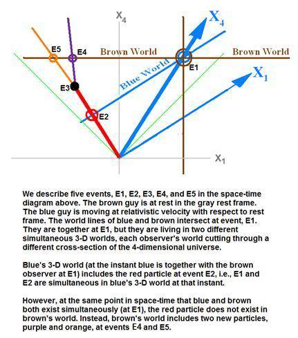

nkpstn
Is it possible for a particle to exist according to one reference frame and simultaneously not exist according to another?
If energy is relative, can a collision between two particles have enough energy to produce new particles according to its own reference frame but not have said amount of energy according to a 3rd particle's reference frame?
Just started reading about relativity, apologies if question is noobish and/or redundant.
Hi nkpstn, welcome to PF.
No, it is not possible for a classical particle to exist and simultaneously not exist. The relativity of simultaneity refers to disagreements about the simultaneity of spatially separated events. Since a particle is not spatially separated from itself there is no disagreement.

That's not a noobish question at all, nkpstn. I believe you may have something in mind like this. I've prepared a space-time diagram to illustrate the situation. The blue guy and the brown guy in the sketch exist simultaneously, and yet the red particle exists in the blue guy's simultaneous 3-D space but it does not exist in the brown's simultaneous 3-D space (the red particle has decayed into orange and purple particles).

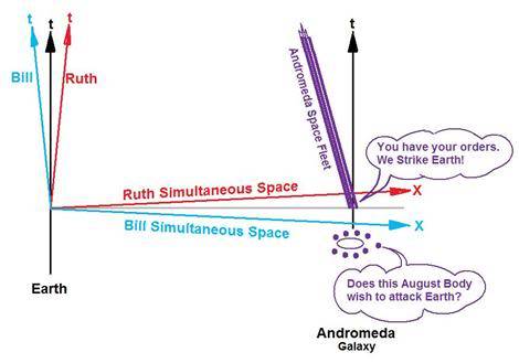

That's a good observation, pervect. And I don't think you don't even need an accelerated frame for that. I think the Andromeda Paradox (below sketch) presented by Roger Penrose supports the concept you are suggesting. Ruth and Bill walk past each other, and their relative velocities (even at this slow speed) result in them living in two different 3-D worlds; one 3-D existence of the Andromeda Galaxy is simultaneous with Ruth (is in Ruth's world) and a different 3-D galaxy existence is simultaneous with Bill (is in Bill's world).
In Bill's 3-D world (one cross-section of the 4-D universe) the government somewhere in the galaxy is trying to decide whether to attack earth. In Ruth's 3-D world (a different 3-D cross-section of the 4-D universe) the decision has already been made and the attack is under way.

So what? What is the problem?
I think that, whenever the Andromeda "paradox" is mentioned, one should also mention that there is no problem at all, no paradox. Otherwise it is misleading.
The attack was launched or not. That is an event, so it cannot be controversial in SR.
Let us assume the attack was launched. If that is simultaneous, in Ruth's frame, with her meeting Bill, that means the two events (the meeting and the launch of the attack) are spacelike, so there is no causal influence between them. In other words, if Bill (taking advantage of the fact that in his frame the attack has not yet happened) wanted to prevent it by sending a diplomatic message, the latter would not arrive in time for that purpose, because the distance would be too long for any infra-luminal or even luminal messenger to cover it before the time when the attack would also start according to Bill.
But what determines if the attack was actually launched or not? Well, it is precisely a bunch of situations like this. A bunch of events. Focus on any other situation of this sort that you can imagine and solve it according to these rules. You will realize that the story is the same in all frames.
There is not problem at all. It is just a simple example implying that the universe is 4-dimensional, allowing different 3-D worlds as different cross-sections of that 4-D universe. Once the universe structure and ingredients of special relativity are understood all of the so-called paradoxes become obvious, and there are no paradoxes at all. And the events are what they are in space-time, and all observers will agree that those events are there.
