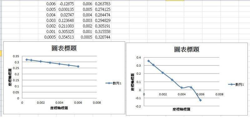

As derived by the lab manual i received, frictional force can be plotted as a function of axle radius.
f=2mgMR(R-2r)/(3MR^2+4m(R+r)^2)
The graph plotted using my experimental data is very strange...
Two line graphs with Chinese titles 圖表標題 and y-axis labels 座標軸標題, both plotted from 0 to 0.008 on the x-axis; the left graph is a nearly straight downward-sloping line from about 0.32 to 0.26, and the right graph is a steeper line falling from about 0.36 to -0.13 with a small bump near x = 0.005.
Both graphs are plotted by f as a function of r. The one on the right is plotted according to my experimental data. The one on the left is a plot of the equation above. Why the graphs are so different? Is there anything wrong?
It seems like you have one bad data point in your experimental graph and the plot of the function is incorrect. What were the masses m and M and what is the radius R? The function ought to change signs at r=R/2.
M = 5.743 kg
m = 50.42 g
R = 0.06355 m
i see the problem...it is a horrible and stupid mistake in changing unit...thanks for reminding
our professor reminded us that the graph is non-linear and do not have to do fitting
but the graph is fairly linear except the "bad data".
is there any other possible explanation leading to this deviation?
A good guess would be that the value +0.030135 should be -0.030135.
