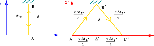

In this image, we have a bar, on the lower mark we have placed a lamp and on the upper a mirror as shown. At some point the lamp goes on and the light reaches the mirror, it reflects and goes back from where it started. The events A = light emition and B = return at starting point are two events which take place in the same reference frame (Σ). For Σ the light traveled a distance equal to 2(AB) = 2d with speed C. So Δt = 2d/c
Observer Σ along with the bar, move with velocity v in relation to Σ' to the right. Therefore Σ' will notice that the light follows the track Α'Β'Γ' with velocity c...
Can somebody please explain to me, why the light follows the track Α'Β'Γ', I can't seem to "feel" the above image.
P.S. If you have any links that will help me with the understanding of special relativity or have some exercises (With solutions or answers) i would be very thankful.
If the emitter emits light straight up in our frame when it's at rest in our frame, then it must continue to emit light straight up in its new rest frame if it's given some constant velocity relative to our frame--if this wasn't true it would violate the first postulate of relativity, which says all the laws of physics should work the same in each inertial frame, so two observers in closed rooms moving at constant velocity relative to one another should get the same result if they each do the same experiment in their own room.
And of course, if the emitter continues to shoot light straight up in its rest frame when it's moving in our frame, that implies that in our frame the light will have to move diagonally (so it always remains directly above the emitter even as the emitter moves).
