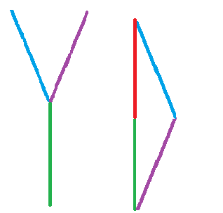

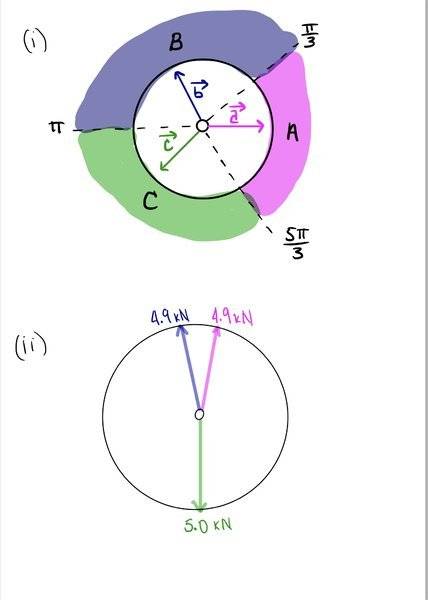

I'd like to ask another question if that's alright. To keep the clutter minimized, I figured I'd just ask it in here rather than in another thread as it pertains to the same subject mostly.
If you'll look at the attached image, it is a representation of a 3-way tug-of-war, where three teams have ropes attached to a ring. I got this problem off of Khan Academy. The first picture is a representation of the word problem given.
Now according to the video, the team with the most magnitude in their direction wins. If you'd shift your attention to the lower picture, which I made up so you can visualize my question, this is where I'm a little confused.
In the diagram, it is clear the the green vector has the most magnitude out of the three. However, in looking at the blue and the pink, they are very close to the magnitude of green. Additionally, they are pretty much pulling in the same direction as each other. Now to me, it seems that although green has the highest magnitude, it wouldn't be able to overcome the somewhat combined magnitudes of the blue and the pink. So who wins here?

opus said:
So who wins here?
The red line is the resulting force pointing upwards: green + violet + blue = red

Apologies for the late response. Been juggling two classes so I've been jumping back and forth between the trig and algebra.
I'm not entirely sure what you mean here. So if the red is pointed upward, that would mean that green loses, even though it has the single highest magnitude?
All forces apply to the same point. To get the resulting force you have to add them. Vector addition is moving one at the end of the other and the result is from the old origin to the new end point. Here we have 9.8N up and 5 down, so a result of approximately 5N up shouldn't be a surprise. To calculate the exact value, you need some angles and perform a bit triangle trigonometry.

The directions the teams are pulling in the two drawings don't seem to agree. Is the is the second one correct?
It's good practice to provide a link or post the whole problem word for word.
The solution is to add the three vectors together and work out the direction of the resultant. The direction of the resultant determines who wins, the magnitude determines how fast they win. The direction will depend on "which team has the most magnitude in their direction".
By this, do you mean that all forces are being applied on the center ring?
Ok I think I got this part. Because vectors are defined only by their magnitude and direction, so we can move them around in space as long as we don't change their magnitude and direction. So we move the force vectors around so that they are in a manner that can be added.
So the first drawing is from the word problem. The second (lower) drawing is one I used to frame my general question.
In the first drawing, they are pulling in a fairly spaced apart manner. I made the second picture to show a situation where two vectors that are pulling in close directions are pulling against a vector of higher magnitude.
My train of thought was as such:
The green vector has magnitude of 5.0 kN. The other two vectors are pulling almost opposite of the green, but each have a lower magnitude of 4.9 kN. Since the green vector has the highest magnitude, it would win. But then I thought that the two smaller vectors are essentially pulling with each other, so their combined force would overcome green's.

Here is a link to the word problem, which I found on Khan Academy:
In the video, we solve for the magnitude of all three force vectors and vector b has the greatest and is said to win. I looked at this problem and asked "what if the vectors weren't so evenly spaced, and what if two were very close together? Would it still be true that the team with the highest magnitude wins?"
Yes. If they apply at different points, then it depends on the situation. A force applied on me and one on you won't add up at all. At different points on the same piece of steel there will be a force translation in the material, which e.g. could lead to bend it.
Correct.
Yes. Imagine three teams pulling on ropes. Which team would you place your money on?
Well, do the trig computations. The highest magnitude will win, as long as you define the highest magnitude according to the direction properly. If you pull something heavy straight up, you will never move it horizontally, no matter how hard you pull it upwards: ##\cos 90° = 0\,.##
The green vector has magnitude of 5.0 kN. The other two vectors are pulling almost opposite of the green, but each have a lower magnitude of 4.9 kN. Since the green vector has the highest magnitude, it would win. But then I thought that the two smaller vectors are essentially pulling with each other, so their combined force would overcome green's.Here is a link to the word problem, which I found on Khan Academy:
It's only the team with the highest magnitude under the symetrical case. If you change the direction in which the teams are pulling but not the position of their winning zone then it's possible for a weak team to win. The general solution is to look at the direction of the resultant and see which win zone it points to.

Ok now that my finals are done, I've been able to come back to my side questions and I think I have a better understanding of this.
So if the three teams here are having their tug-of-war, and the case is symmetrical (which I will assume means that they have equal distance between each other), then the team with the highest magnitude wins. However, if the case is not symmetric, as shown in my drawing, then the angles are taken into account and it is possible for a team with a weaker pulling force to win. In this case, we'd want to add up all the force vectors (which include magnitude and direction), and this will tell us where the ring will go.
Is this correct?
Yes. As I said above. The direction the ring takes is the vector sum (aka the resultant or net) of the three vectors applied by the teams.
This can be applied to both symmetric and non-symmetric cases - it's just that the symmetrical case is simpler to analyse.
Edit: Strictly speaking the resultant or net force give the direction in which the ring will accelerate. In this case the initial velocity is zero so its also the direction it will move, but in other problems that might not always be true.
