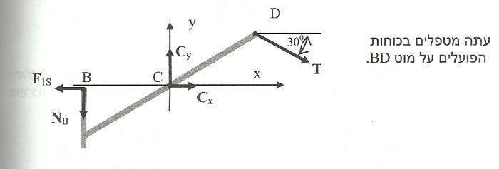

Which I accept as valid, but then when you isolate the second body:
http://img217.imageshack.us/img217/7923/aa3rq.jpg
You see "friction", but you don't see the force applied on the object by the two claspers. Does it make sense?
-FP
Very sharp! :smile:
Yes, there is force exerted by the claspers.
So there would also be a downward force at A and an upward force at B (which would cancel each other out).
Aha! It was ignored. I got to tell you, I'm not at all happy about the solution manual *tsk tsk tsk*
Thanks again mei angele custos :)

The first and second free body diagrams do not match indeed.
They should have drawn the claspers in the second diagram in the same place as in the first diagram!
*tsk tsk tsk*

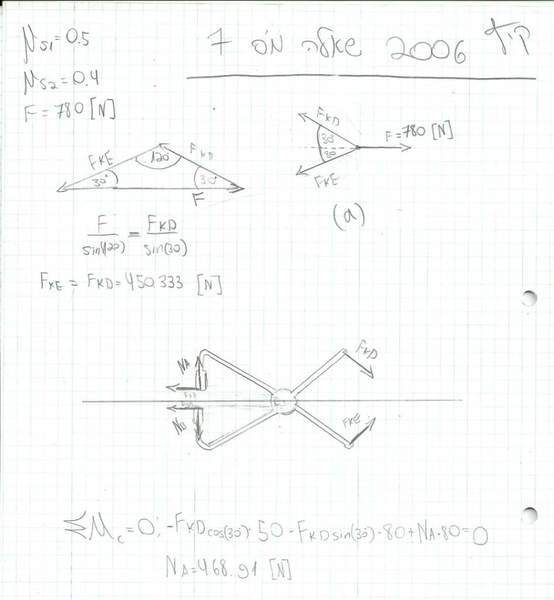

Pardon the interruption, but I do believe that when solving a symmetrical shape we get to isolate one half of it. Is that correct? Look what I did trying to solve for Na. It is my humble opinion that if the friction force at Na had any arm, the result would be different. However, the result I turned up with is exactly like the solution manual says. (attached are my calculations. Again, I only used the upper part of the shape)
So this is why this post
However, if you would have to calculate something, the distance between A and B won't matter.
The forces will come out the same (I think).
Is rather conflicting to me.
No, you always solve the entire shape, although symmetry will often show you beforehand that some forces or moments will for instance cancel out.
However, what you did not take into consideration yet, is that the body you have is not rigid. It has a hinge in the middle allowing free rotation, so you need to treat it as 2 separate free bodies.
Well, I tried solving for the entire shape and it's impossible to get to Na that way. However, looking at only half of the object, I get the correct result for Na (as shown in my attachment above).
A 2nd method to solve fo Na would be to isolate one of the diagonal beams. However, again, unless the friction force is acting on the same plane at C, you can't solve for either Na or the friction force. (beam isolation diagram attached from the manual)
But if C is a pin-connected, can't I look at the entire body first with all the "external forces" acting on it before I isolate it? In the 2nd body diagram at my first post, the one I'm using, they didn't write down any force at C, so they're presumably seeing it as a rigid body.
I'm confused.
The last attachment is apparently from you solution manual, and it shows that they have taken one diagonal beam as a free body.
It also contains a force at C.
And if you do the moment sum relative to C, you can solve it for Nb.
Btw, if you take the 2nd body diagram at your first post as a rigid body, it can not "clasp".

Yes, but only if we presume that the friction force has no arm at C! Remember our initial discussion about whether it's important for the friction force to have an arm?
The quote:
So in my last attachment of the diagonal beam, that distance would matter!
So the second body diagram is wrong and unrealistic?
My bad!
You're ever so right! :smile:
Yes, the distance would matter.
Since we know now that the distance would matter, we need the distance to solve the system. However, since it is not given we will have to make an assumption.
What if the neck of the bottle is very small compared to the contraption?
Then we could neglect the size of the neck of the bottle, that is, treat the distance as zero.
This would make the second diagram more realistic than the first diagram!
Great, so our diagram is more realistic than the actual picture drawing lol. I blame them for not giving/defining a proper distance so we have to make assumptions instead. Very tricky. I'd disqualify this question if I was in charge of the tests. Thank you as always Serena for helping me sort through that. :))
Well, in reality, the contraption would be meant to be used for different size bottles.
So then you would have to do the calculation twice.
Once for a bottle with the smallest neck possible, and once for a bottle with the largest size the contraption can still hold.
If you would do the numbers, you will find that the smaller the neck-size, the smaller the normal force, and with a smaller normal force, comes a smaller friction.
So a neck-size of zero would correspond to the ultimate worst case scenario, where the contraption might not be able to move the bottle.
This is exactly what a user of the contraption would want to know, and what would be a part of the specification of the contraption.
I suspect these deliberations are a bit out of scope for the problem at hand though.

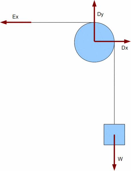

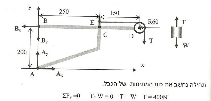

While we're on the issue of false diagrams. Can anyone explain why there's no force T (rope tension) emerging from point E in this FBD? Compare the FBD of the solution manual to mine. IMO, mine makes a whole lot more sense.
These are not free body diagrams.
These are diagrams of the total system with only the external forces drawn.
Actually, the rope tension is not an external force, but the real external force is the gravity force W which is pointing downward.
In the solution manual, they have replaced W by the tension force T (in the same direction) which is naughty.
The force T you drew at E is an internal force, and it's to early to draw that one, because then other internal reactive forces would have to be drawn as well.
[edit]Note that I consider the rope and the wheel at D as separate free bodies.[/edit]
*smacks forehead* Right. Internal. My mechanics intuition needed some recalibration, thanks :)
I'm not sure why it is "naughty", but since YOU said it's naughty, I will forever henceforth write T as W in such cases!
Not that there's anything so wrong with being naughty... ;)
Ah well, there's actually a 4th free body which hasn't been drawn, and I guess it should have been drawn.
That is the mass that is suspended on the rope.
If we look at the free body diagram of this mass, there are 2 forces:
1. The gravity force W
2. The upward rope tension T that is equal and opposite to W.
The downward rope tension T that has been drawn in the solution-manual-diagram, is actually the reactive force.
