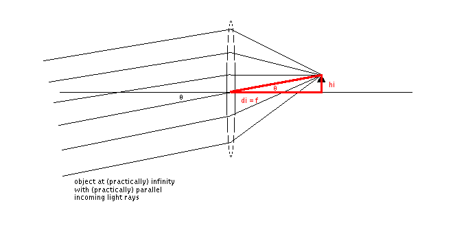

This is the critical point. Let's say that the heigth of the object is y_0, the focal length is f, and the distance from the focal point to the film is x_i (as in the first picture in http://www.inyourfacefotos.com/fstop.htm). Then by similarity of triangles the heigth of the image will bee y_i=\frac{y_0}{f} x_i, that is it will be inversely proportional to f and thus the intensity I \propto f^2. The question is what is wrong in this reasoning?
That diagram isn't really appropriate for this question. Try the attached one instead. For an object of given size and distance from the lens, the angle \theta is fixed. Looking at the red triangle, it should be obvious that if \theta is fixed, then the image height h_i is proportional to the image distance d_i. If the object distance is much larger than the focal length, then the image distance is practically equal to the focal length. Therefore the image height is practically proportional to the focal length.
Aah, I see, the problem with my formula was that if I changed f, x_i would change too. Your picture, jtbell, explains it very well. Thank you very much for your time.
