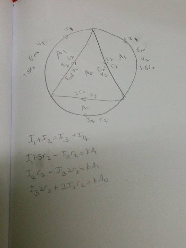

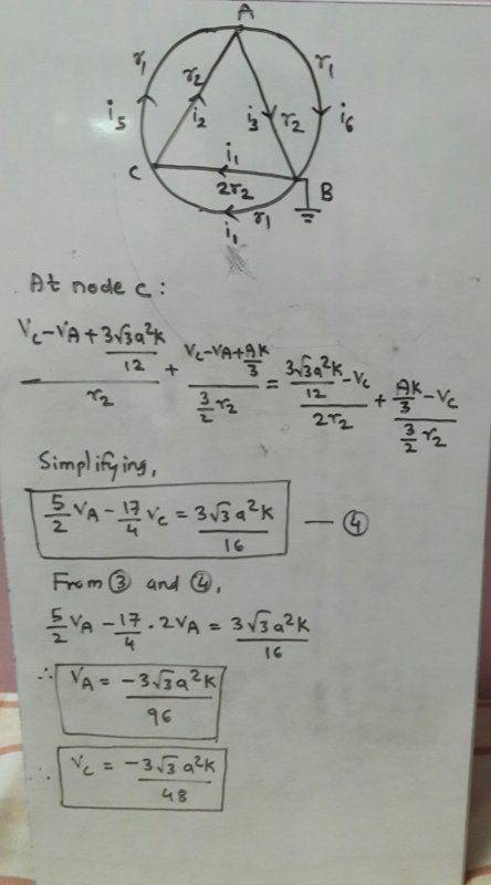

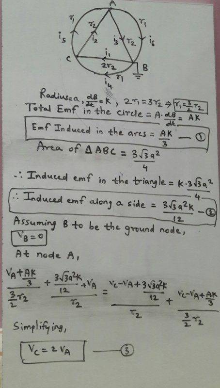

Faraday's law -- circular loop with a triangle
The discussion revolves around a circular coil connected to an equilateral triangle, with a uniform magnetic field that is decreasing over time. Participants are tasked with finding the potential difference between two points, A and B, while exploring the implications of Faraday's law in this context.
  • Participants discuss the transformation of the circuit and the implications of induced electric fields being non-conservative. Questions arise regarding the validity of circuit transformations and the role of different paths in calculating induced emf.
There is an ongoing exploration of the relationship between the induced emf and the layout of the circuit. Some participants are questioning their reasoning and assumptions, while others are providing insights into the effects of geometry and resistance on the calculations. Multiple interpretations of the problem are being considered.
Participants express confusion regarding the application of Faraday's law, particularly in relation to induced emf and potential difference. There are references to the specific resistances in the circuit and how they influence the readings of a voltmeter, indicating a need for clarification on these concepts.

  • #117
so let the static fields in upper circle be ##E_{su}## in segment AB be ##E_{sh}## and in lower circle be ##E_{sl}##
right off the bat we can see that in segment ab the only field is ##E_{s2}## hence
E_{sh}L = I \rho L
if the left hand side is the voltage then the right hand side is the answer.
for voltage in bc
lower circle there are two opposing fields
(\frac{k r_2}{4 \pi} - E_{sl}) \pi r_2 = I \pi r_2 \rho
upper circle there are two supporting fields
(\frac {k r_1}{4 \pi}+E_{su})\pi r_1 = I \pi r_1 \rho
we need a third equation relating ##E_{su}## and ##E_{sl}##
this can be obtained from the condition that the static fields are curless hence going in loop should give zero.
hence third equation
2 E_{sh}L + E_{su}\pi r_1 - E_{sl}\pi r_2= 0
we know ##E_{sh}## from previous part hence the three equations could be solved to get ##E_{sl}## from voltage bc can be gotten as ##L E_{sl}##
  • #118
then as to the pdf file that rude man attached i think the solution follows in the same way as there will definitely be build up of charges at the junctions hence the solution follows in almost exact manner
\frac{emf}{4r}+\frac{v}{2r} = I\\
\frac{emf}{2r} - \frac{v}{r}=I\\
v = \frac{emf}{6}
as to what the voltmeters read in both the questions i am not sure voltmeters are screwing with my brain
