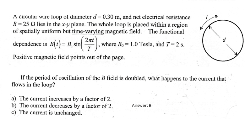

Please check picture below.
http://i.imgur.com/OrqKc.png
If T=T/2, shouldn't my current become half?
An emf will be induced in the coil given by Faraday's law
emf = rate of change of magnetic flux linkage
This will give rise to an induced current since there is a closed loop
