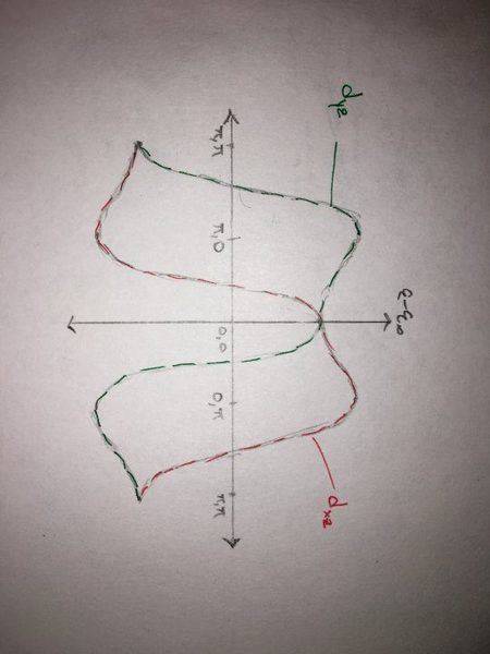

This is schematic band structure for the dxz and dyz orbitals using a 2D square Fe lattice. What is the location in the Brillouin zone of the hole-like Fermi surface and the electron-like Fermi surface?
Wow. It would be nice if you oriented the picture so that we don't have to crank our necks to look at it.
Question: where is the Fermi energy level in your sketch?
