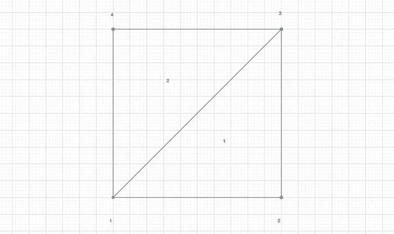

Suppose I have a simple two element problem like the reference you sent me with nodes labeled counterclockwise and the element number inside;
Then suppose the local stiffness matrix for element 1 is
$$k_1 = \begin{bmatrix}
a_{1,1} & a_{1,2} & a_{1,3}\\
a_{2,1} & a_{2,2} & a_{2,3}\\
a_{3,1} & a_{3,2} & a_{3,3}
\end{bmatrix}$$
And for element 2 is;
$$k_2 = \begin{bmatrix}
b_{1,1} & b_{1,2} & b_{1,3}\\
b_{2,1} & b_{2,2} & b_{2,3}\\
b_{3,1} & b_{3,2} & b_{3,3}
\end{bmatrix}$$
I believe the local stiffness matrix for element 1 will go into the global stiffness matrix like this;
$$K_1 = \begin{bmatrix}
a_{1,1} & a_{1,2} & a_{1,3}&0\\
a_{2,1} & a_{2,2} & a_{2,3}&0\\
a_{3,1} & a_{3,2} & a_{3,3} &0\\
0 & 0 & 0 & 0
\end{bmatrix}$$
but I am confused as to how to add the second one.

Ok, I think the contribution of element #2 to the global stiffness matrix will go like this;
$$K_2 = \begin{bmatrix}
b_{3,3} & 0 & b_{3,1}&b_{3,2}\\
0 & 0 & 0 & 0\\
b_{1,3} &0& b_{1,1} & b_{1,2}\\
b_{2,3} &0& b_{2,1} & b_{2,2}
\end{bmatrix}$$I used an ordering like this since the counterclockwise sense of nodes for element #2 goes as {3,4,1};
341
b_{1,1}b_{1,2}b_{1,3}3
b_{2,1}b_{2,2}b_{2,3}4
b_{3,1}b_{3,2}b_{3,3}1
I'm fairly sure this is correct.
