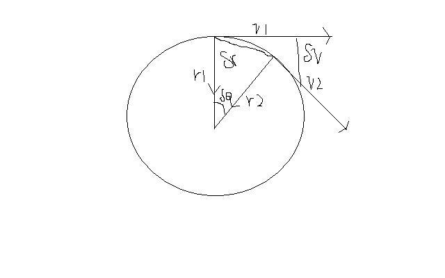

I would have thought the average acceleration is the change in velocity/change in time
No, you haven't done the problem correctly. You didn't determine the velocities correctly yet.
Draw a picture of the Ferris wheel. Label the point at the bottom as t=0. Which way does the velocity point and what is its magnitude? Now consider where that point is when t=5 min. The Ferris wheel takes 30 minutes to do a complete revolution, so after 5 minutes, by how many degrees will it have rotated? Which way does the velocity now point and what is its magnitude?
Should the point at the top be labeled as t = 0?
aaverage→ = Δv/Δt
change in Θ = 2π/60 . 5 = 0.523 radians
ratio of change in radial displacement to change in velocity
Δr/r = Δv/v
Δr: Δr^2 = r1^2 + r2^ - 2.r1.r2 cosΘ
Δr = 38.78m
velocity = Δp/Δt
p(2) = (75 sin 0.523 , 75 cos 0.523) = (37, 65)
p(1) = (75 sin 0 , 75 cos 0) = (0 , 75 )
Δt = 5
∴[p(2) - p(1)] / 5 = | [(37 , 65 ) - ( 0 , 75) ] | /5 = | (37, -10) |/5 = 7.7ms^-1
Δv = (Δr/r). v = 4ms^-1
aaverage→ = Δv/Δt
∴4ms^-1 / 5 = 0.8ms^-2
That's not correct. First, what is ##\omega##, the angular speed of the Ferris wheel?

Give me a number. You use that quantity in various places, but every time you do, it's a different number. It seems like you plug in numbers at random.

Well, for instance, the following isn't correct.
vela said:
##\omega##
If ω = ΔΘ/Δt
and ΔΘ = 0.523 radians since 2π = 60mins, therefore, 5 mins = 0.523 radian,
and Δt = 5 mins over the 0.523 radians
then
ω= 0.1046
Why do you think ##2\pi = 60\text{ minutes}##?
I might have misread the question.
It should be ##2\pi = 30\text{ minutes}##
Is this the only blunder?
No, you've made other mistakes; the biggest is using ##v_\text{avg}## for ##v##.
The magnitude of the average acceleration should turn out to be ##8.73\times 10^{-5}\text{ m/s}^2##.
