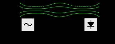

Here there is a photo about the concentration of the field on the resonant coil by wikipedia
bocchesegiacomo said:
Here there is a photo about the concentration of the field on the resonant coil by wikipediaView attachment 218552
That is no help at all.
Go to the References section of the Wikipedia article you are reading, and find the mainstream source for the information you want to discuss please.

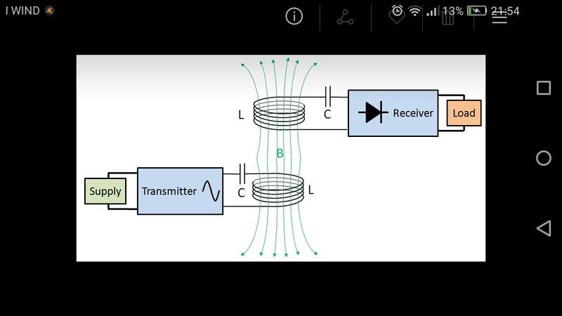

Here is the right image
Here is the right imageView attachment 218553
And notice how the two coils are lined up closely, so there is a lot of coupling between them. That is how some electric toothbrushes are charged when placed in their holders next to the sink. That is not far-field energy transmission.
I hope that makes sense now.
