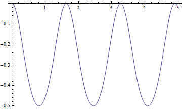

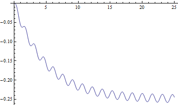

Not sure if there is a clean analytic solution, but let's just take a look at some numeric results. For sake of simplicity, I took m=1kg, k=1, g=10m/s².
Plots are attached.
Figure 1. a(t)=5*θ(t) m/s². This is the test case to compare to your solution. It does, in fact, show turning point at x=-a/(gk) = -0.5m. Fantastic. Moving on.
Figure 2. a(t)=(5*t) m/s² for t<1s and 5m/s² for t>=1s. The turning point is now around -0.35m. The bead does continue to oscillate, but it never gets to the -a/(gk) mark. So the solution is wrong for this case. Can we do better?
Figure 3. a(t)=(5-5 Exp(-t/5)) m/s². Let's see what happens if we turn up acceleration gradually. What do you know? The maximum value attained by x is just over -a/(2gk). That really should not surprise you. If you increase acceleration gradually, the bead is always near equilibrium, and so does not attain high speeds needed to overshoot the equilibrium.
Why does conservation of energy method fail for all but the first case? Because energy is not conserved in an accelerated frame of reference in general. Yes, under constant acceleration, we can pretend that there is a potential function. But that is not generally true otherwise. Use of energy conservation for this problem is completely misleading.
So what's the conclusion? The way the problem is stated, it has no definite solution. It simply makes no sense to ask how high the bead will climb without being very specific about how the acceleration is turned on. It makes sense to ask for an equilibrium position, but nothing else. Especially when you are talking about using the setup as an accelerometer, and in any realistic situation there will be friction, and equilibrium position will be used.
