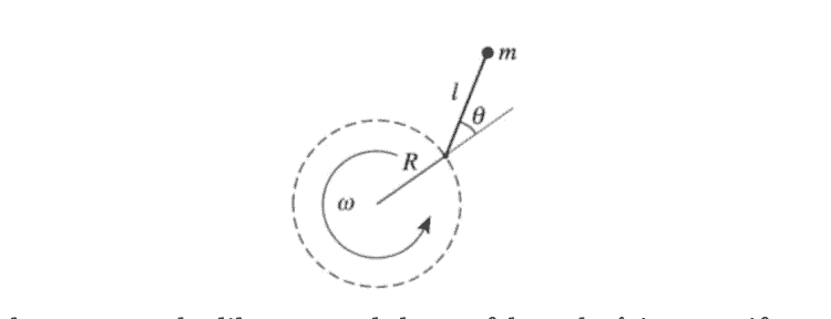

A pendulum is designed for use on a gravity-free spacecraft. The pendulum consists of a mass at the end of a rod of length l. The pivot at the other end of the rod is forced to move in a circle of radius R with angular frequency ω. Let θ be the angle the rod makes with the radial direction. Show this system behaves exactly like a pendulum of length l in a uniform gravitational field g = ω𝑅^2. That is, show that θ(t) is a solution for one system if and only if it is for the other.
F=wR^2
I was confused by how to work this problem in a rotating frame. The solution read that the centrifugal force on the mass should be of magnitude 𝑚𝑤𝑅^2. However, I thought it would be 𝑚𝑤𝐿^2 where L is the distance between the mass and the center of the circle (L = l + R). What am I missing here?
  • Diagram of a rotating disk of radius R with angular velocity ω (counterclockwise arrow). A rod of length l extends from the rim at angle θ to a point mass m at its outer end.
I think you need to make some approximations based on assuming that ##R \gg l##. I don't like it that they said "behaves exactly like..."

If that diagram came with the question, it does not intend ##R \gg l##.

Yes, thanks. I jumped the gun. It turns out that no approximations need to be made other than neglecting the Coriolis force.
[Edit: Actually, since the Coriolis force would act along the pendulum rod, it would only affect the tension in the rod. It would not affect the equation of motion for ##\theta##. So, I think there is an exact correspondence!]

Let ##r## be the instantaneous distance from the center of the circle of radius ##R## to the pendulum bob. How would you express the centrifugal force ##F_c## on the bob in terms of ##r##? Use some trigonometry to find the component of ##F_c## along the tangent of the circle of radius ##l## that the bob moves along. Nice simplification occurs.

The centrifugal force on the bob is in the radial direction from the center of rotation of the rod, and is given by ##m\omega^2 \bf{L}##. So the centrifugal force is not that produced by a uniform gravitational field. You need to determine the component of this force in the theta direction of the bob motion (see figure). When you complete the analysis, the motion will be the same as if the rod were not rotating and the bob were in a uniform gravitational field of magnitude ##g=\omega^2R##.
