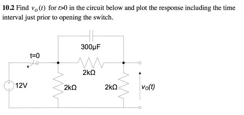

Find ##v_o(t)## and plot it.

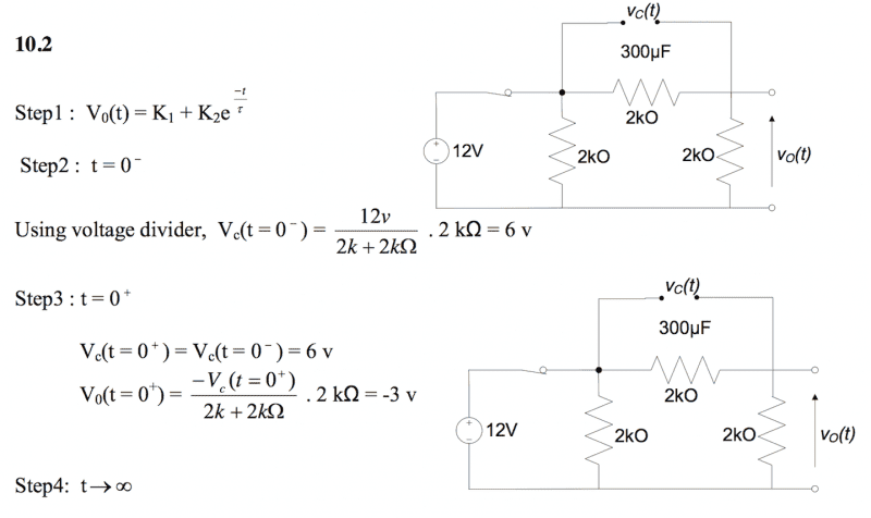

The solution was provided, and I got all of the same numbers except for one thing. For some reason, in step 3 there is a negative sign in front of ##v_c(t = 0^+)## when calculating ##v_o(t = 0^+)## using a voltage divider.
Could someone shed some light to where that came from or is it simply an error?

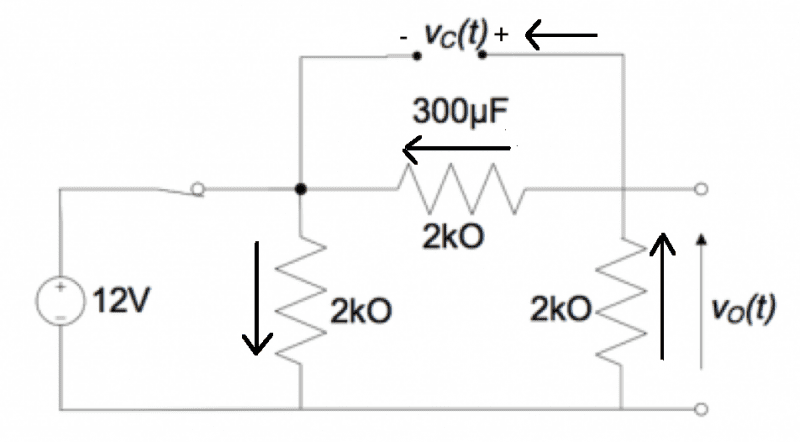

So you mean the capacitor discharges like so:
So the current will flow head to tail through the 2k.

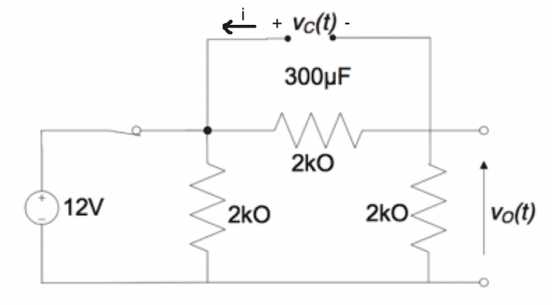

Draw the current through each component.
I hope that looks okay now.

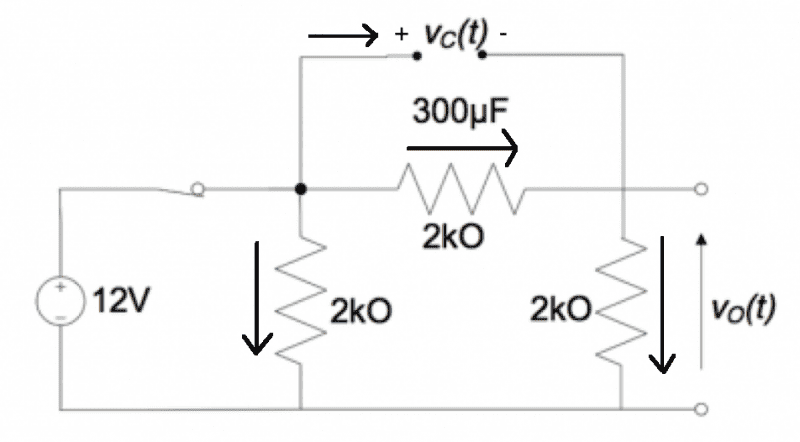

You have both currents through the 2k resistors heading downwards into the same node. Where does the current go? (think KCL)
I'm honestly a little confused if that's not the case.
You're making things worse! You've changed the polarity of the charge on the capacitor for no reason. Your original figure was correct: the capacitor was charged (at steady state) to the potential difference across the 2k resistor in parallel with it.
Current flows from higher potential (+) to lower potential (-). Current leaving the + terminal of the capacitor flows around the circuit to make its way back to the - terminal of the capacitor. You will not find current heading away from the - terminal of the capacitor!
