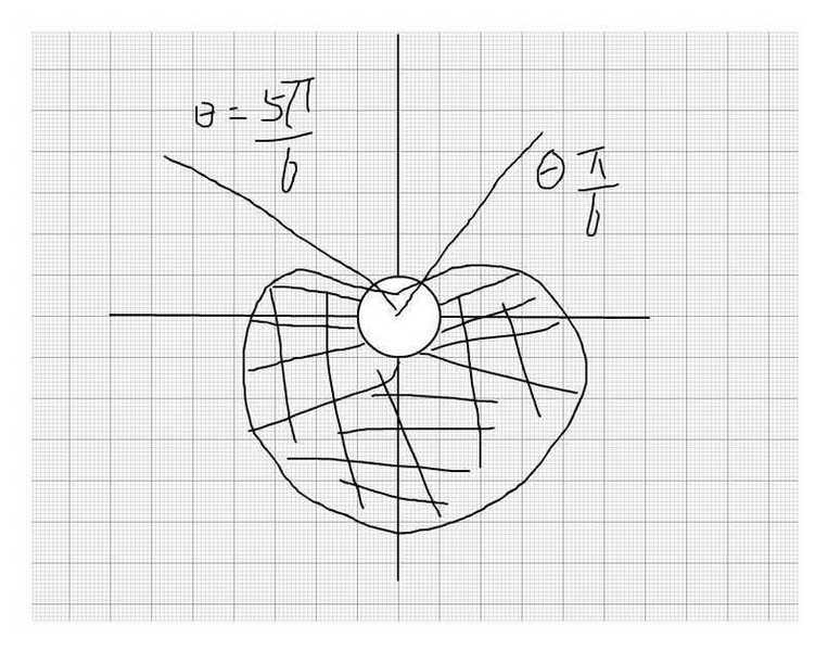

set up a double integral to find the area of the region inside the cardioid r=2-2sin θ and outside the circle r=1.
setting the two equations equal to each other, I got theta = pi/6 , 5pi/6
Area= ∫-5pi/6 to pi/6 ∫1 to 2-2sinθ rdrdθ
I am not sure if my bounds for the lower angle is correct or not.
any help is appreciated
here is the graph:

The -5π/6 is not correct.
-5π/6 + 2π = 7π/6 is at the same location as -5π/6 .
You need a negative angle which terminates at the same place as 5π/6 .

Your graph shows intersections for ##\theta = \pi/6## and ##\theta = 5\pi/6##. Above you have ##-5\pi/6##.

I think @SammyS is correct, -7pi/6 should work, I think it as it goes from -7pi/6 to pi/6, counterclockwise. but i don't understand the need to add 2pi, since 7pi/6 is the actual angle if you go clockwise from 0.
I didnt understand what @Mark44 said, or he is misunderstanding my question.
what do you think?
what do you think?
Yes, "it goes from -7pi/6 to pi/6, counterclockwise".
If you are referring to my adding 2π, I was merely pointing out that -5π/6 is co-terminal with 7π/6 and that is incorrect for a limit of integration.

What I said was that in your drawing, you show one of the angles as being ##5\pi/6##, but in your integral (below), you are using ##-5\pi/6## as a limit of integration.
