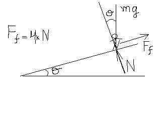

A skier starts from rest at the top of a hill that is inclined at 9.1° with the horizontal. The hillside is 250 m long, and the coefficient of friction between snow and skis is 0.0750. At the bottom of the hill, the snow is level and the coefficient of friction is unchanged. How far does the skier glide along the horizontal portion of the snow before coming to rest?

Do you know the mass of the skier?
No, i do not know the mass of the skier.
That is weird because friction force depends on the normal force which depends on the mass of the object.

Yes but there is friction in the slope also. In my opinion this problem should be split into two parts, first find the velocity and the end of the slope then find the distance required to stop. The later one can be solved using work energy theorem, but I still don't see how to do this without the mass. Sorry, maybe someone else can help you more. Good luck.

the skier gains kinetic energy on the way down. at the bottom of the slope Ek = Eg-W
W= (coefficient of kinetic friction * mass * gravity)(distance along the slope)
so then you just take Ek at the bottom and sub in for W=uFn*d
W/uFn = d
