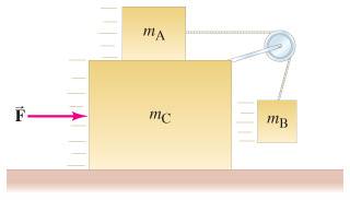

Diagram of three blocks: block mA sits on top of large block mC, connected by a cord over a pulley at the upper right to hanging block mB; a horizontal force F pushes mC from the left, on a frictionless floor.
[/B]
Determine a formula for the magnitude of the force F exerted on the large block (mC) in the figure so that the mass mA does not move relative to mC. Ignore all friction. Assume mB does not make contact with mC.
F = ma

Diagram of a frictionless pulley system: block mA sits on top of larger block mC, which has a horizontal force F applied to its left face; a string runs over a pulley at the upper right and hangs down to block mB.
[/B]
F = ma

You almost had it right, but not quite. The key to doing this problem correctly is to get the force balance on mass B correct.
Let T be the tension in the string and let θ represent the angle that the string attached at mass B makes with the vertical (i.e., the string is not vertical). In terms of T and θ, what is the horizontal component of the string tension on mass B? In terms of T and θ, what is the vertical component of the string tension on mass B? How does the horizontal component of acceleration of mass B compare with the acceleration a of mass A? What is the vertical component of the acceleration of mass B? In terms of T, θ, mB, and a, what is the horizontal force balance on mass B? In terms of T, θ, mB, what is the vertical force balance on mass B. In terms of T, mA, and a, what is the horizontal force balance on mass A?
If you did all this correctly, you will now have three equations in three unknowns: T, θ, and a. Solve these equations for the acceleration a.
By the way, when you finish with all this, you will find that you get the same answer that NascentOxygen gave.
