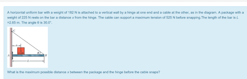

Find max distance box on hingedbeam can be before rope snaps
7 replies · 2K views · last reply
isukatphysics69
453
Diagram of a horizontal uniform bar hinged to a vertical wall at end A, supported by a cable from the wall at C to end B; a box marked COM sits on the bar at distance x from the hinge, angle θ at B, bar length L.
torque = force * distance
Torque forces :
TForceTensionRopeY - TBOX - TBEAM = 0
Net forces Y:
∑FY = FTensionRopeY + FHingeY - WBEAM - WBOX = 0
Net forces X:
∑FX = FHingeX - FTensionRopeX = 0
This is my first torque problem so i want to make sure that i have all of my forces properly, i have been spinning wheels here for 30 minutes unable to solve. I will continue trying but want to see if i have all of the forces correctly

You need the torque equation only. Write the torques with respect to the hinge. Take the tension equal to the maximum value.

I believe i need the y component only of the tension tho
525 = 1.325*182 +x*225
525 - 241.15 = x*225
283.85/225 = 1.26m = x was incorrect
That is why i had the other equations so that i can find that y component of the tension​

How is the torque defined? What is the torque of the tension?
You have the angle between the rope and the bar (30 °).

I have defined the torque as negative downwards and positive upwards
torque is force*distance
So i see what youre saying here i think, 525sin(30)*2.65
this would be the maximum force in the y direction multiplied by the distance. This is the torque of the rope

Yes. So what did you get for x?

2.019 meters thank you!
