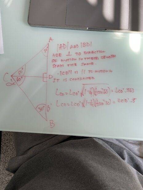

Three metal rods are joined to form a triangle so that the interior angles of the triangle are: 30◦, 60◦, and 90◦ The triangle is at rest in spacecraft so that is entirely in the x'y'-plane with it’s hypotenuse along the y'-axis. The spacecraft is moving away from a stationary observer in the x direction at speed c/2. . Determine the angles of the
triangle as measured by the stationary observer.
sqrt(1-v^2/c^2)

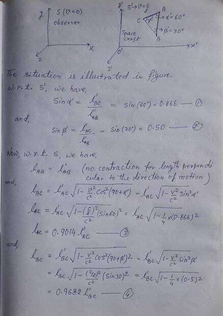

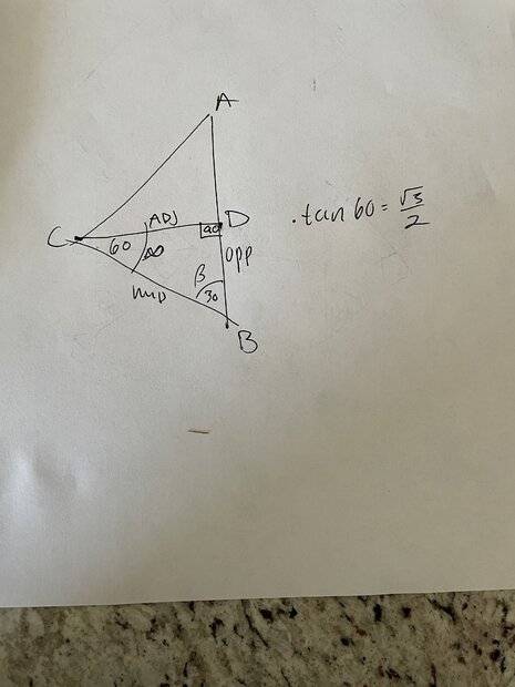

I am trying to follow the work to this question but am stumped at steps 3 and 4.
I am confused as to where the cos^2(90+θ) comes from? I can see it is used to invoke sin into the equation since we have that value. Is it because we are only measuring the x-component of the movement, so we need to find the sin equivalent of cos?
Before I try to figure out the calculation posted, wouldn’t it be simpler to drop a perpendicular from C to AB, meeting it at D, and consider the contraction of CD?
Working that way I get ##\tan(\alpha)=3/2##, giving 56.3°.

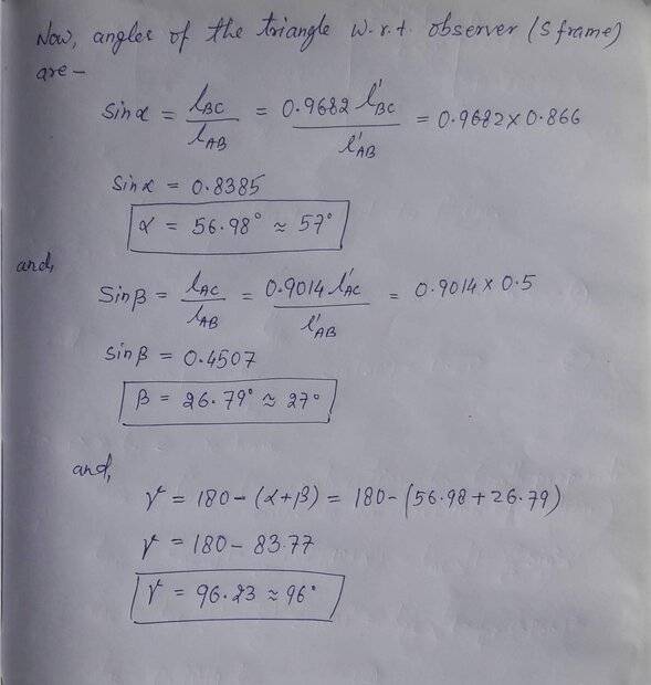

It looks like the first page of the calculations finds the unprimed length ##l_{AC}## by Lorentz contracting the primed length ##l'_{AC}##. This is done by using the component of the relative velocity of the frames that is parallel to the side AC according to the primed frame: ##v \sin{\alpha'}##.
That seems to work!
But, on the second page, we find
This is not correct, since the triangle ABC is not a right triangle in the unprimed frame.
2 minutes later, I arrive at the same conclusions.

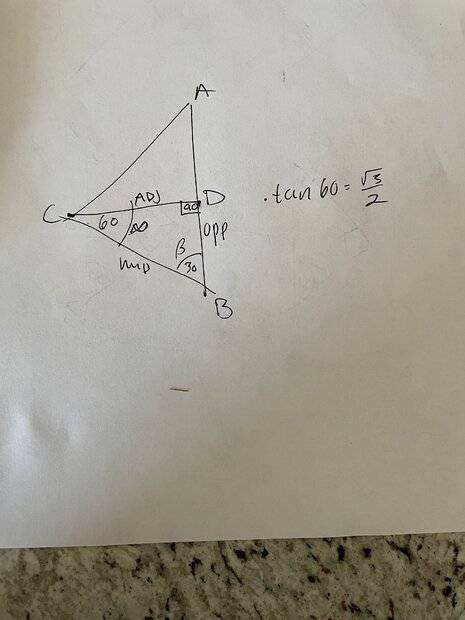

Do you think you can provide a drawing of your explanation on post #2? I am having hard time visualizing it and understanding how the angles would be effected.

Draw the right angled triangle ABC' and drop a perpendicular from C' to meet AB at D. Under the contraction, we can leave A, B where they are and contract C'D to CD.
Express ##\tan(\alpha)## in terms of AD, CD. Similarly ##\tan(\alpha')##.

Ok this is my interpretation of your description. So doing this allow me to measure just the x-direction of the triangle moving?
Yes. The distances ##AD## and ##BD## are the same in both frames and ##CD## is contracted in the frame of the "stationary" observer.

You have a triangle with known side lengths. You just calculate the angles.

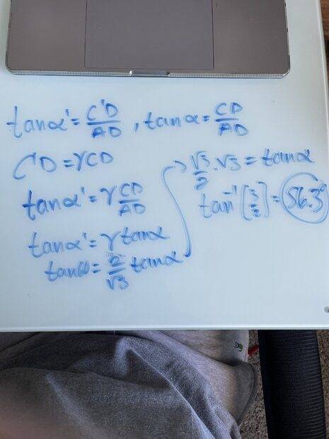

So I calculated the unprimed length of CD and I got 56.3 degrees.
Im confused on what length tan30 is associated with?

You know ##|AD|##, ##|BD|## and ##|CD'|##. You know that ##|CD| = |CD'|/\gamma##. So, you calculate ##\alpha## and ##\beta## from that using basic trig.
Or, get ##\tan \alpha## in terms of ##\tan \alpha'## etc.

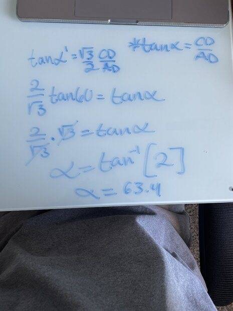

IThis is how I am interpreting the situation. Is this still not correct?
Why do you have a factor of ##\tan ^2 60^o## inside the Lorentz contraction factor?

I guess I was basing this off of what the original work had done. But thinking about it harder I can see why id doesn't make sense.
Im just not seeing what everyone else is seeing to conclude the problem.
Calculating Lcd=Lcd' \gamma I get .866. That should be the only length I need to calculate since the other two lengths are perpendicular.
Now that I have Lcd=lcd'(.866) what do I do. How do I calculate alpha and beta from this?
How would you express ##\tan \alpha## in terms of ##L_{CD}## and ##L_{AD}##?
Tan(α) = LAD/LCD .
If I know LCD=LCD'*√ 3/2, then I just need to find LAD?

You don't need to find ##L_{AD}##. The idea is that you can express ##\tan \alpha## in terms of ##L_{CD}## and ##L_{AD}##. Likewise you can express ##\tan \alpha'## in terms of ##L_{C'D}## and ##L_{AD}##. Since you know the relation between ##L_{CD}## and ##L_{C'D}##, you should be able to see the relation between ##\tan \alpha## and ##\tan \alpha'## .

First, the tangent is opposite over adjacent.
And ##\tan \alpha' = \frac{|C'D|}{|AD|}##.
That gives you a relationship between ##\tan \alpha## and ##\tan \alpha'##. With the same idea for ##\beta## and ##\beta'##.

So then ##\tan \alpha = \frac{|CD|}{|AD|}##?

##\tan \alpha' = \frac{|C'D|}{|AD|}##. I can see that, i got this wrong on my earlier post because I was looking at the wrong angle.
I don't see how I can relate this to ##\tan \alpha##
Well I guess If AD is the same in both frames, then I can say AD = C'D/ ##\tan \alpha'## and also AD = C'D/ ##\tan \alpha##
So then C'D/ ##\tan \alpha'## = C'D/ ##\tan \alpha## ?

##\tan \alpha' = \frac{|C'D|}{|AD|}##, ##\tan \alpha = \frac{|CD|}{|AD|}##, ##|C'D| = \gamma|CD|##

Okay, but we've done all the work except solve it. There's not much left to do except a final step which gives the answer.
You're honestly saying that you cannot finish the job from here:
Note that ##C' \rightarrow C## is the only point on the triangle that changes from one frame to the the other. The line ##ADB## is unaffected by length contraction, as it is perpendicular to the direction of motion.
