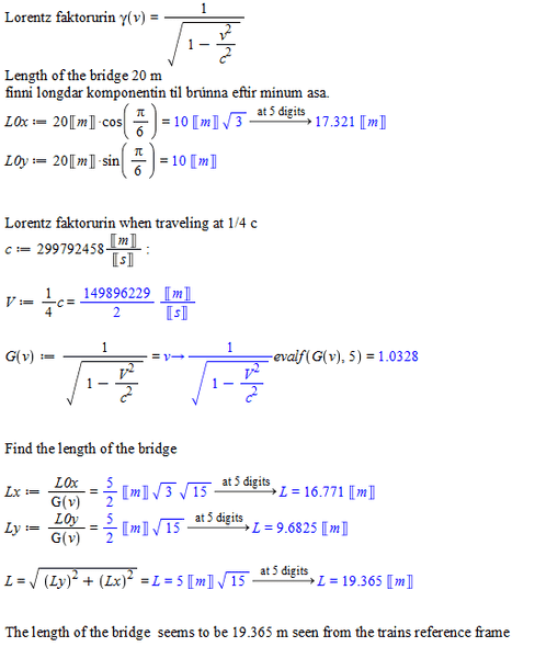

A Train is driving with a uniformed velocity. v=1/4 c. The train is driving under a bridge, which is rotated \theta=30 degree in relation to the railway. The bridges length is 20 m long in a reference frame of the bridge (stationary bridge).
Calculate the length of the bridge, seen from the train (reference frame, follows the train)
Not sure
Projection length
[itex]\Delta x’=L_0 cos\theta_0[/itex]
[itex]\Delta y’=L_0 sin\theta_0[/itex]
[itex]]\Delta x’=]\Delta x[/itex] And [itex]]\Delta y’=]\Delta y[/itex]
The Length L of the bridge measured from the train.
[itex]L=\sqrt{(\Deltax)^2+(\Deltay)^2}=\sqrt{L_0 {\frac (-(-v^2 cos^2 \theta_0}{c^2}+1)[/itex] Or written as [itex]L_0 (1- \beta ^2 \cos^2 \theta_0 )^(0.5)[/itex]
[itex]L=\sqrt{L_0 {\frac (-(-v^2 cos^2 \theta_0}{c^2}+1)[/itex]
[itex]L=\sqrt{20 m {\frac (-(-0.25c^2 cos^2(30 }{c^2}+1)[/itex]
[itex]L=4.472 m[/itex]
*note: think the result comes out a bit low, (assumption based on the Lorentz factor gamma(v)=1.0328)
*Apologize for the mess in the thread, can't get my commands to work in Latex form
Your computation of the Lorentz Factor is correct: 1/sqrt(1-(1/16)) = sqrt(16/15) = 1.0328
So, it should be clear that, with that factor, you aren't going to go from 20 meters to 4.472 meters.
Show me these intermediate computations and I point out your error:
1) Delta X and Delta Y of 20 meter bridge from the bridge's reference frame.
2) Delta X and Delta Y of 20 meter bridge from the trains's reference frame.
3) Length of bridge from trains reference frame.
What is the length contraction factor in the direction of train travel? What is the length contraction factor in the direction perpendicular to the direction of train travel?
Hey, here's my calculations with all intermediate computations
Ups, can see that there is some Faroese in the image, hopefully it doesn't make to confusing.
marimuda said:
Hey, here's my calculations with all intermediate computations View attachment 93049 .
There is no length contraction in the y direction. The contraction in the y direction is 1.0
Chet
Chet
So, I just solve Lx=L0x/gamma(v) and Ly=L0y?
Sure.

I get a slightly different answer.
Now that you're studying more advanced topics, you may want to think about using algebra more than arithmetic. For example, why is the value of ##c## relevant? You are given the velocity ##v = c/4## so ##c## cancels out in the expression for ##\gamma##.
All the intermediate computations are unnecessary. It makes your work difficult to check, because it all boils down to putting numbers in a calculator and checking what comes out.
Also, ask yourself this: what if the angle were 40 degrees or the speed ##c/5##? Or,if the length of the bridge were 50m? Would you go right back to the start and plug in some different numbers with a whole set of different intermediate computatons? Or could you use some elementary algebra to solve for any angle ##\theta## and any velocity ##v = \beta c##? And then simply plug the specific numbers in once at the end?
Thanks for the responds.. Is your answer 19.526 m ? , that's what I got when I did the correction chestermiller pointed out. I know that I need to do some algebraic gymnastics to set it up more efficiently, was just more thinking about if I even was in the right ball park.
We don't have any special relativity course in school, and my 'final project' is about special relativity, So it's kind of new.
Isn't that difficult to cook down one equation and then isolate θ . But I can see that c cancels out since the velocity is given in terms of c units
It's not difficult and in fact you might learn a couple of interesting things from it.
Hint calculating ##L'^2## makes it easier.
Yes, that's what I got.
