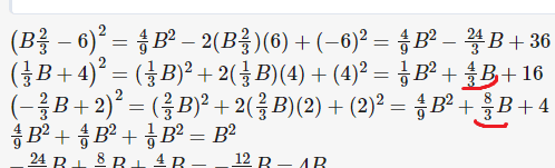

##\left(B\frac{2}{3}-6\right)^2=\frac {4}{9}B^2-2(B\frac {2}{3})(6)+(-6)^2=\frac {4}{9}B^2-\frac{24}{3}B+36##
##\left(\frac{1}{3}B+4\right)^2=(\frac {1}{3}B)^2+2(\frac {1}{3}B)(4)+(4)^2=\frac {1}{9}B^2+\frac{4}{3}B+16##
##\left(-\frac{2}{3}B+2\right)^2=(\frac {2}{3}B)^2+2(\frac {2}{3}B)(2)+(2)^2=\frac {4}{9}B^2+\frac{8}{3}B+4##
##\frac {4}{9}B^2+\frac {4}{9}B^2+\frac {1}{9}B^2=B^2##
##-\frac {24}{3}B+\frac {8}{3}B+\frac {4}{3}B=-\frac {12}{3}B=4B##
##36+16+4=56##
##B^2-4B+56=100##
##B^2-4B-44=0##
##x = \frac {-b \pm \sqrt{b^2 -4ac}} {2a}##
##B = \frac {-(-4) \pm \sqrt{(-4)^2 -4(1)(-44)}} {2(1)}##
##B = \frac {4 \pm \sqrt{16 +176}} {2(1)}##
##B = \frac {4 \pm \sqrt{192}} {2}##
