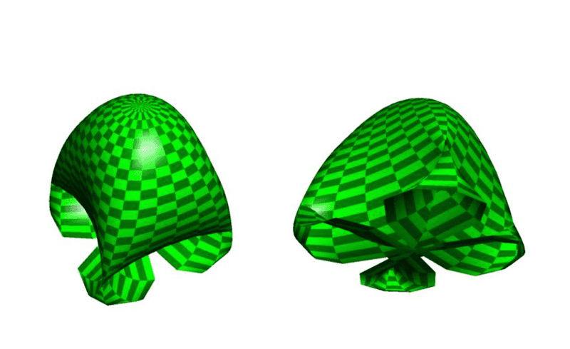

I am teaching myself how to represent such surfaces using Apple's app Grapher. This is what it looks like (two views) if I taught myself correctly. There are hardly any instructions, only examples to modify by trial and error. I changed the ##y##-component from ##12(x^2+2)## to ##12(x^2+2r^2)## in order to make it dimensionally correct.
