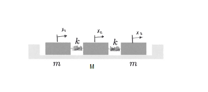

Hi,
I have a 3 mass system. ##M \neq m##
I found the forces and I get the following matrix.
I have to find ##\omega_1 , \omega_2, \omega_3## I know I have to find the values of ##\omega## where det(A) = 0, but with a 3x3 matrix it is a nightmare. I can't find the values.
I'm wondering if there's another way to have the eigenvalues.
##\begin{pmatrix} - \omega^2 +\frac{k}{m} &-\frac{k}{m} &0\\ -\frac{k}{M}& - \omega^2 + 2 \frac{k}{M} &-\frac{k}{M} \\
0&- \frac{k}{m} & -\omega^2 + \frac{k}{m}
\end{pmatrix} \begin{pmatrix}A_1\\A_2\\A_3 \end{pmatrix} =0

I'm not sure to understand the way you set the variables. Why you have ##x## and why not ##W = \omega^2 + \frac{k}{m}##
The eigenvalues are the roots of the polynomial ##\det (A-x\cdot I).## Hence we have ##a_{ii}-x## on the diagonal. You can also work with ##W-x## instead. I simply found it more convenient to calculate ##\det\left(\begin{bmatrix}
W&q&0\\q&V&q\\0&q&W
\end{bmatrix}\right) ## and replace the actual values afterwards rather than
W-x&q&0\\q&W-q-x&q\\0&q&W-x
\end{bmatrix}\right) ##. It's a matter of taste.
You typed ##q = \frac{k}{M}##, but you also replaced ##\frac{k}{m}## by q even if ##M \neq m##. I don't know if it matters.
At the end I have ##VW^2 - \frac{2k^2W}{mM}## = 0. I didn't replace ##\frac{k}{m}##
Using quadratic formula I have ##W = 0 ## and ##W = -4k^2/mM##
then
##-\omega^2 -\frac{k}{m} - x = \frac{-4k^2}{mM}##
It Doesn't give me the right eigenvalues which are, ##\omega^2= 0, k/m , k/m + 2k/M##

You are right. I made a mistake as I used only one mass ##M=m##. Sorry.
My corrected result is ##\det (A-xI)= \ldots##
0=W(VW-2qQ)=\left(-\omega^2+\dfrac{k}{m}-x\right)\cdot\left(\left(-\omega^2+\dfrac{k}{m}-x\right)\cdot \left(-\omega^2+2\dfrac{k}{M}-x\right)-2\dfrac{k^2}{mM}\right)
which results in ##x=-\omega^2+\dfrac{k}{m}## and the quadratic equation
0=x^2+2x\left(\omega^2-\dfrac{1}{2}\cdot\dfrac{k}{m}-\dfrac{k}{M}\right)+\left(\omega^4-\omega^2\dfrac{k}{m}-2\omega^2\dfrac{k}{M}\right)
which is easy to solve (if I haven't made a mistake again).
In case ##\omega ## was your variable, then I do not understand where the square comes from. But then your calculation was correct. I also get ##0\, , \,\dfrac{k}{m}\, , \,\dfrac{k}{m}+2\dfrac{k}{M}.##

Sorry I found my errors. You explanation was perfect. I just didn't realize I don't need to go that far to find the roots for ##\omega##
Thanks!
