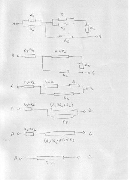

Hi! I have been trying to understand how a "complicated" circiut can be transformed to show which resistors are connected in series and which are parallel... Sometimes I manage to do it but it's often too hard for me because I can't find any sort of algorithm about it. Could anybody show me "step-by-step" how to transform this circuit for example...?

It's always a good idea to label the components in a diagram. In this case your resistors should be numbered R1, R2 etc. This allows people to identify what is being referred to and, if the OP doesit, doesn't waste 2 posts.
Alternatively you can label the connection nodes, A, B, C etc (which you have already started, but not finished).
I will comment (ask) if your diagram is correct since R1 and R2 are (almost) shorted out.
Can you see which resistors I mean by R1 and R2?

First of all, thank you for the very quick response... I have labeled the resistors... Now, how can I find the equivalent one.
P.S. The answer is 3 ohms.

I find it often helpful to redraw the network to bring out the relationships. Sometimes you have to do this several times to get a clear result.
The attachment shows a sequence of single step series or parallel simplifications leading to the desired result.
Although I agree with the 3 ohm answer I have left you do do some of the work in the intermediate steps.
Hope this helps
  • Series of six hand-drawn circuit diagrams between terminals A and B, showing successive series and parallel reductions of resistors R1 to R5, ending with a single 3 ohm resistor.

Well.. thank you once again! :) I hope now I can figure out HOW to do it myself...
