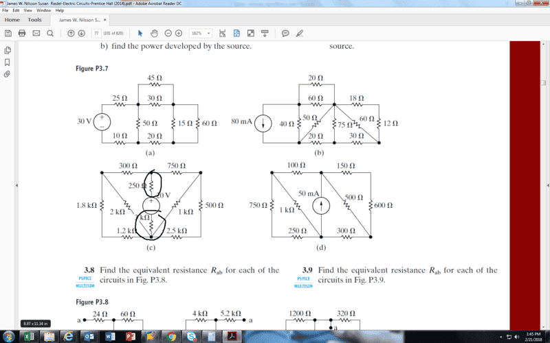

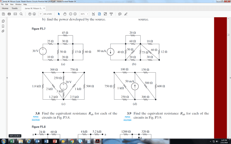

problem in title:
1/Rtotal = 1/r1 + 1/r2...[/B]
[/B]
I can get it down to 4 resistors...but the one's I have circled I don't know how they behave. I just need a little kick in the right direction lol. Thank you in advance!
Textbook figure P3.8 showing four resistor networks labeled (a) to (d), each with terminals a and b; network (c) has a 250 ohm resistor and a 1.2 kilohm resistor highlighted by hand-drawn circles.
  • Screenshot of a textbook page showing circuit diagrams labeled Figure P3.7 (a) and (b) with resistors in ohms, a 30 V source, and an 80 mA current source, plus Figure P3.8 and P3.9 circuits with resistor networks.
  • Textbook figure P3.8 showing four resistor networks labeled (a) to (d), each with terminals a and b; network (c) has a 250 ohm resistor and a 1.2 kilohm resistor highlighted by hand-drawn circles.
tensor0910 said:
problem in title:
[/B]
Can you show your work? It looks like those resistors fold up pretty well...
Please show your work.
If you are on the right track, two of the four resistances can be converted into one resistance and only 3 resistors remain in the circuit, two of which are your circled ones. You could then see how they behave.

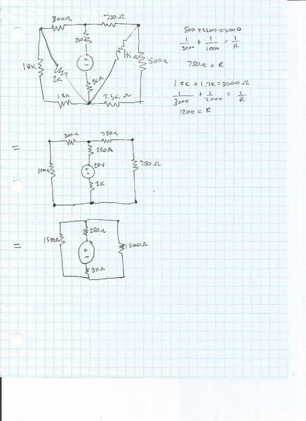

here is my work so far. sorry for the delay
Handwritten circuit simulation on graph paper: top circuit with resistors 300 ohm, 750 ohm, 200 ohm, 1K, 500 ohm, 2K, 1.2K, 3.5K, and a 9 volt source; middle and bottom simplified circuits with 30 volt and 3K source and resistor labels 250 ohm, 750 ohm, 1000 ohm, 1500 ohm.
  • Handwritten circuit simulation on graph paper: top circuit with resistors 300 ohm, 750 ohm, 200 ohm, 1K, 500 ohm, 2K, 1.2K, 3.5K, and a 9 volt source; middle and bottom simplified circuits with 30 volt and 3K source and resistor labels 250 ohm, 750 ohm, 1000 ohm, 1500 ohm.
Okay, so what's the next step? Can you find any more resistances that are in parallel?

Resistance in parallel means they have 2 common points.
ok I got it now. Sorry guys not my strongest subject lol. Thanks for all the help!
Suppose your last diagram was rearranged into the diagram below. Then is it clear what the next step is? The two diagrams are equivalent.

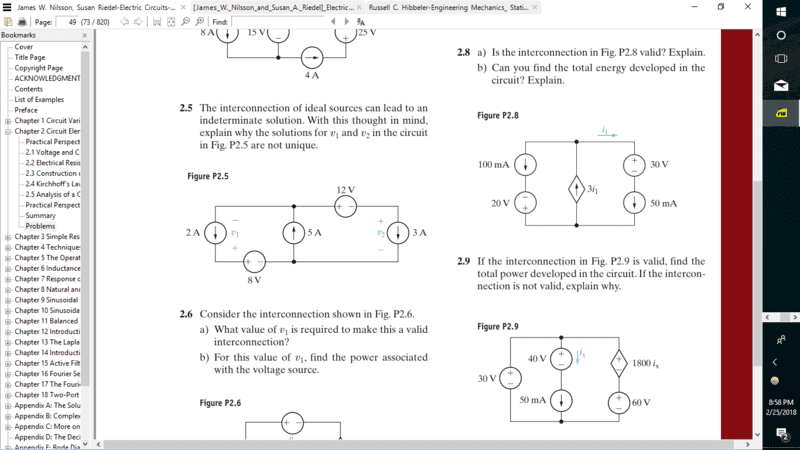

see that makes sense to me. they're in parallel. But my book has this for example: ( Figure P2.8)
There's two different voltage sources but they're connected in parallel, right? How can that be?
Textbook circuit schematic labelled Figure P2.8, showing a current source of 100 mA and a dependent current source of 3i1 in parallel with two voltage sources of 20 V and 30 V.
  • Textbook circuit schematic labelled Figure P2.8, showing a current source of 100 mA and a dependent current source of 3i1 in parallel with two voltage sources of 20 V and 30 V.
Circuit schematic labeled Figure P2.8 with current i1 marked at the top wire: a 100 mA current source in series with a 20 V voltage source on the left branch, a dependent current source 3i1 in the center branch, and a 30 V voltage source in series with a 50 mA current source on the right branch.
I don't see any voltage sources connected in parallel. Both of the the sources are in series with current supplies.
