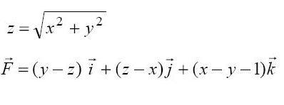

I need to find the flux of this vector field (in the pic) that goes through this plan (in the pic) and z goes from 0 to 1.
How am I suppose to do that?
The surface is [itex]z= \sqrt{x^2+ y^2}[/itex], the upper nappe of a cone. In cylindrical coordinates, that is z= r. So good parametic equations would be [itex]x= r cos(\theta)[/itex], [itex]y= r sin(\theta)[/itex], [itex]z= r[/itex] which means that the vector equation would be
[itex]\vec{r}(r, \theta)= r cos(\theta)\vec{i}+ r sin(\theta)\vec{j}+ r \vec{k}[/itex]. Since z goes from 0 to 1, r goes from 0 to 1 and [itex]theta[/itex], of course, from 0 to [itex]2\pi[/itex].
Does that help?

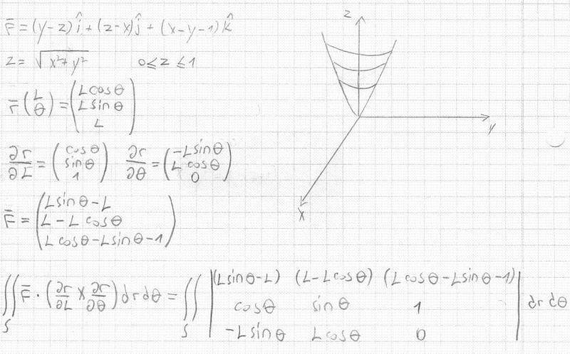

Check this out, is that what you meant?
Once you have done the cross product, and the integral, yes, that should be correct. I would recommend you do the integrations with respect to [itex]\theta[/itex] first. Most of those trig functions, integrated from 0 to [itex]2\pi[/itex] will give 0.
