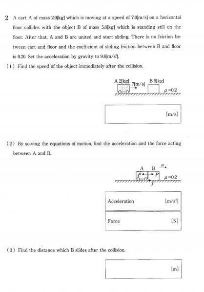

1. The problem statement, all variables and given/known data
B at rest. A moves 7m/s and bump into B. Object A is frictionless. Object B not, coeff of friction = 0.2.
g = 9.8 m/s2
After collision both objects moves together with speed 2 m/s to the right.
Let refer C for force between objects. (What we have to find)
Object B as system
##C - F_{friction} ## = ##mass_B## . a
Object A as system
##F_A## - C = ##mass_A## . a
I am still confused to make fhe force system for B or A. How is the correct force system?
How to find that C? When we don't know ##F_A##?
Please help me..

I have to say I'm confused as well. Are you sure this is the whole question?
http://[url=https://ibb.co/diBMon]https://preview.ibb.co/jd8dZS/20180504_004628.jpgthis is the whole question. Hope it shows clear
[ATTACH=full]225086[/ATTACH]
Okay. That makes sense now. So, you've solved part 1).
What determines what happens in part 2)?

Well... they both moving together.. now.. there is friction working and acceleration slow them down
What slows them down?
Friction at mass 2 right?
Right. So evaluate that frictional force.
5*9.8*0.2 = 9.8 N
B as system
C - F_friction = Mass_B * a

Helly123 said:
B as system
Yes.
What about the other block?

F_A - C = Mass_A * a
haruspex said:
What is F_A?
The force makes A move?
That sounds rather pre-Newtonian. Forces make things accelerate.
What forces are acting on block A after the collision?

Force of contact with b because of friction too?
Pre-Newtonian?
You have the force of contact with B represented by C in your equation in post #16. I am asking about this mysterious FA in that equation. What is it? Where does it come from? We are told there is no friction between A and ground.
Yes.. the force that moves A
Something that accelerate A to move into b?
Maybe there is no F_A since we focus on the collision?
The collision has happened. We are dealing with the subsequent acceleration. There is no FA.
So combine your equations for the two blocks and solve.
