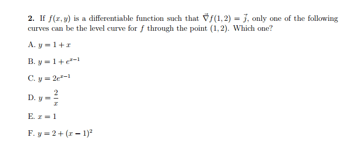

Multiple-choice question 2: gradient of f at (1, 2) equals j; options A through F give candidate level curves y = 1 + x, y = 1 + e^(x-1), y = 2e^(x-1), y = 2/x, x = 1, and y = 2 + (x - 1)^2.
The answer is F. I don't how to get this. I know that it is perpendicular and must have a horizontal tangent. How do I come to this answer?[/B]

Let's look at one choice and see why it isn't an answer.
D. y = 2/x
Let f(x, y) = y - 2/x
Then ##\nabla f = <-2x^{-2}, 1>##, so ##\nabla f(1, 2) = <-2, 1> \ne \vec{j}##

I understand, but why is f(x,y) = y- 2/x
I'm defining that way. With this definition, f(x, y) = 0 is equivalent to y = 2/x.

Can we always define it as being this way ?
When you're talking about level curves, as this problem is, the equation y = 2/x represents the level curve f(x, y) = 0, with f(x, y) = y - 2/x.
Here's another way to look at it. Each of your examples except (E) is of the form ##y=f(x)## for some ##f(x)##. It's not good form to use ##f(x,y)## in the same problem you have ##f(x)##, so call ##F(x,y) = y - f(x)##. Then ##\nabla F(x,y) = -f'(x)\hat i + 1\hat j## so ##\nabla F(1,2) = -f'(1)\hat i + 1\hat j =0 \hat i + \hat j## means ##f'(1) = 0##. That is quick and easy to check for each ##f(x)## and you will easily will see (F) works.
